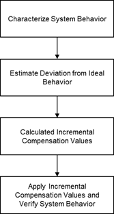

The basic steps are:
  • Characterize system behavior (applying device compensation values)
  • Estimate deviation between real and ideal behavior (calculate delta between ideal behavior and measured behavior)
  • Calculate incremental compensation values (delta values)
  • Apply compensation during operation and verify system behavior

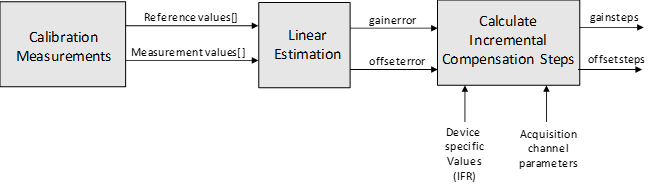

The following picture indicates which information / data is required to calculate the incremental gain and offset adjustments (gainsteps, offsetsteps).
For a good estimation of the acquisition channels behavior, e.g. a 5-point measurement is suitable.
The selection of the individual data points should consider application requirements like:
  • desired input range
  • area where highest accuracy is desired

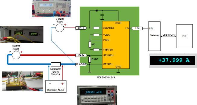

  • capability of the module / device (e.g. minimum supply voltage for Vsup)
  • capability of equipment (e.g. max. Iout of power supplies, max. input range of DMM and related accuracy in the range)
  • select current points for ISENSE calibration such that no gain switching is required
The picture below shows an example setup for the ISENSE channel compensation:
