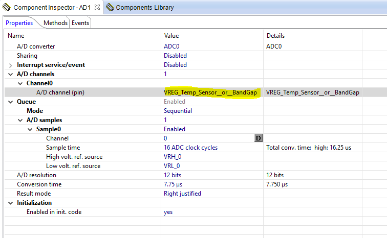

I am using PE to set the ADC to measure temperature with the on-chip VREG temp sensor:
And I can switch the CPMUHTCTL register between the band-gap voltage and temperature to get a calibration point for the conversion calculation: CPMUHTCTL_HTE = 1, CPMUHTCTL_VSEL = 1 for bandagap voltage; CPMUHTCTL_HTE = 1, CPMUHTCTL_VSEL = 0 for sensor voltage.
My problem is that the sensor voltage ADC reading doesn't vary over temperature. I have tested it over a range of +- 10 degrees and always get exactly the same ADC reading, to the last bit. The ADC value is quite different from the ADC value with the bandgap voltage set, so I know I'm not still measuring the constant bandgap voltage. I'm using the GetChanValue16 method to read the ADC after calling the Measure method.
Is there anything I've missed, because as I understand from all the various references, there is a sensitivity of about 1.75 mv / degree C, which should make the ADC value change over the temp range I'm testing it at ?

In fact, the external settings are not irrelevant. You configured ADC to use VRH_0/VRL_0 signals as the reference. According to RM: ”ADC reference Voltage signal VRH_1 is mapped to VDDA and VRH_0 is mapped to PAD3. VRL_1 is mapped to VSSA and VRL_0 is mapped to VSSA.”
So, if you didn’t connect any external reference voltage to PAD3 pin, please use VRH_1/VRL_1 signals as the reference.
The Temperature Sensor Slope should be around 5.25mV/°C. See Table E-1. Voltage Regulator Electrical Characteristics (Junction Temperature From –40°C To +175°C) in RM.

I came back to this after testing properly and calibrating with some known temperatures. You are right, using VRH_0/ VRL_0 isn't correct and gives a wrong reading. Thanks !
