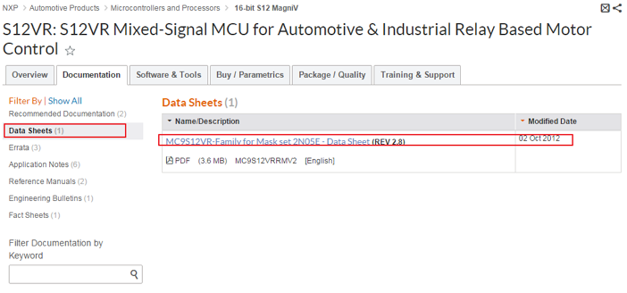

But i cannot find the Conversion Result Registers of Supply Voltage Sensor(Chapter 16) and Chip temperature sensor(section 4.3.2.13) in Datesheet.
Someone can help to explain for me?

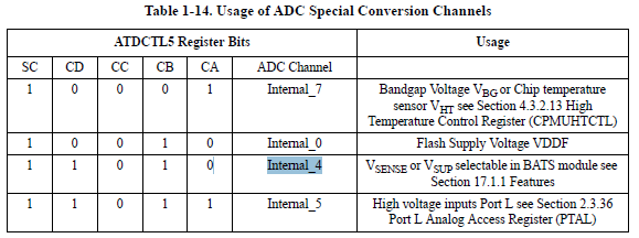

The Conversion Result Registers is the same for all ADC measurements - ATDDR0~ATDDR5.
The internal channels are routed to ADC by setting SC bit in ATDCTL5 register.
Please look at Table 1-14. Usage of ADC Special Conversion Channels in RM (page 51, RM Rev4.2) for channel settings of internal channels.
So, the Bandgap Voltage VBG or Chip temperature sensor VHT are measured on Internal_7 channel and VSENSE or VSUP voltage is measured on Internal_4 channel.
Prior ADC measurement, you have to also configure the appropriate module. For example:
CPMUHTCTL=0x08; // temperature VHT signal, the voltage amplifier is enabled
Or
BATE=0x08; // BATS VSUP ADC Connection Enable
I hope it helps you.

It looks like some mistakes in "MC9S12VR Family Reference Manual, Rev. 2.8".  I hope official team can update this information ASAP.
