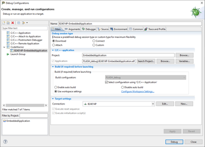

When using CodeWarrior11 software to debug and download programs to the S12ZVM chip, the eeprom inside the S12ZVM chip will also be erased. How can I configure the download so that the internal eeprom is not erased?
采用CodeWarrior11软件给S12ZVM芯片调试下载程序的时候,S12ZVM芯片内部的eeprom也会一起擦除,怎么配置下载可以不擦除内部的eeprom
473 Views
fqh

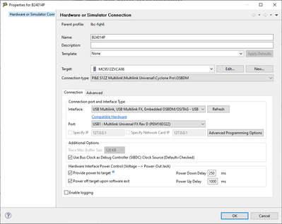

click Edit...

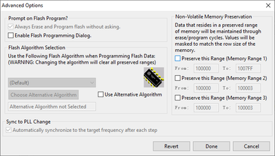

click Advanced Programming Options
check Preserve this Range (Memory Range 1)
