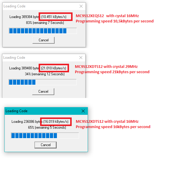

Eric_t
Hi Batrova.
Sorry for the misunderstanding.
By "programming speed" I mean the time that needs codewarrior to programm the firmware to controller.
The picture below, shows the programming speeds.
As you can see, for mc9s12xdt512 with crystal 16MHz, the programming speed is 16kB per second, while with crystal 29MHz is 21kB per second.
For mc9s12xeq512, it is even worst. The programming speed with crystal 16MHz is only 10kB per second.
The problem is that for large firmwares (almost 512kB), the programming time is way too long and slows down the debugging procedure.
Especially for mc9s12xeq512, the programming time is unacceptable long.
I suppose that there is way to speed up the programming procedure.
As far as I understand, during programming procedure, the PLL is OFF and this is the reason of the slow programming times.
I have made some measures with the following pemicro algorithms for cyclon pro.
-   Freescale_9S12XDP512_1x16x256k_512k_Linear_16k_page.12P
-   Freescale_9S12XDP512_1x16x256k_512k_Linear_16k_page_pll.12P
The algorithm with the PLL, activates the PLL and gives 25MHz bus frequency, reducing the programming time by 20 seconds.
So, my question is, if there is a way to tell codewarrior to activate the PLL when programming the firmware in order to reduce the programming time?
Or is there any other way the reduce programming speed?
