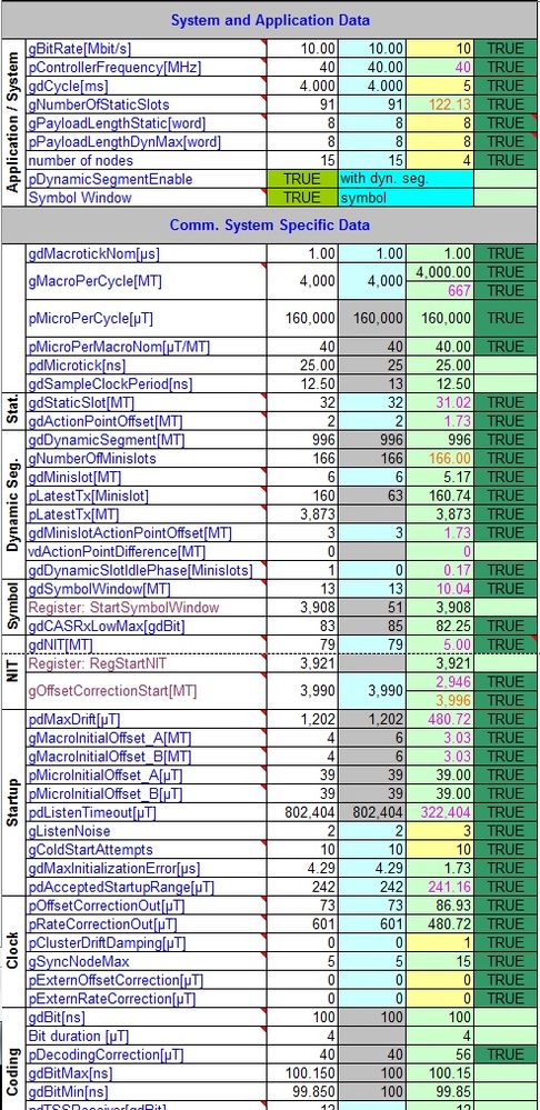

I am trying to start a FlexRay bus with 2 EVB9S12XF but the bus wont start up.
I get stuck in the "vfnFlexRay_Init" after "Fr_start_communication".
The Boards send the first Startup Frame but then nothing more happens and the loop
while(Fr_get_POC_state() != FR_POCSTATE_NORMAL_ACTIVE)
        protocol_state = Fr_get_POC_state();    /* Load current POC state */
is endless.
my configurations are:
const Fr_low_level_config_type Fr_low_level_cfg_set_00 =
    15,         // G_COLD_START_ATTEMPTS
    2,          // GD_ACTION_POINT_OFFSET
    79,         // GD_CAS_RX_LOW_MAX
    1,          // GD_DYNAMIC_SLOT_IDLE_PHASE
    6,         // GD_MINISLOT
    2,          // GD_MINI_SLOT_ACTION_POINT_OFFSET
     24        // GD_STATIC_SLOT
    13,         // GD_SYMBOL_WINDOW
    9,         // GD_TSS_TRANSMITTER
    59,         // GD_WAKEUP_SYMBOL_RX_IDLE
    50,         // GD_WAKEUP_SYMBOL_RX_LOW
    301,        // GD_WAKEUP_SYMBOL_RX_WINDOW
    180,        // GD_WAKEUP_SYMBOL_TX_IDLE
    60,         // GD_WAKEUP_SYMBOL_TX_LOW
    2,          // G_LISTEN_NOISE
    3636,       // G_MACRO_PER_CYCLE
    2,         // G_MAX_WITHOUT_CLOCK_CORRECTION_PASSIVE
    2,         // G_MAX_WITHOUT_CLOCK_CORRECTION_FATAL
    289,          // G_NUMBER_OF_MINISLOTS
    91,         // G_NUMBER_OF_STATIC_SLOTS
    3632,       // G_OFFSET_CORRECTION_START
    8,         // G_PAYLOAD_LENGTH_STATIC
    15,          // G_SYNC_NODE_MAX
    0,          // G_NETWORK_MANAGEMENT_VECTOR_LENGTH
    TRUE,      // G_ALLOW_HALT_DUE_TO_CLOCK
    0,         // G_ALLOW_PASSIVE_TO_ACTIVE
    FR_CHANNEL_A,  // P_CHANNELS
    212,        // PD_ACCEPTED_STARTUP_RANGE
    2,          // P_CLUSTER_DRIFT_DAMPING
    48,         // P_DECODING_CORRECTION
    1,          // P_DELAY_COMPENSATION_A
    1,          // P_DELAY_COMPENSATION_B
    400242,     // PD_LISTEN_TIMEOUT
    121,        // PD_MAX_DRIFT
    0,          // P_EXTERN_OFFSET_CORRECTION
    0,          // P_EXTERN_RATE_CORRECTION
    4,          // P_KEY_SLOT_ID
    TRUE,       // P_KEY_SLOT_USED_FOR_STARTUP
    TRUE,       // P_KEY_SLOT_USED_FOR_SYNC
    1850,        // P_KEY_SLOT_HEADER_CRC
    268,         // P_LATEST_TX
    3,          // P_MACRO_INITIAL_OFFSET_A
    3,          // P_MACRO_INITIAL_OFFSET_B
    6,         // P_MICRO_INITIAL_OFFSET_A
    6,         // P_MICRO_INITIAL_OFFSET_B
    200000,     // P_MICRO_PER_CYCLE
    126,       // P_OFFSET_CORRECTION_OUT
    121,        // P_RATE_CORRECTION_OUT
    FALSE,      // P_SINGLE_SLOT_ENABLED
    FR_CHANNEL_A,   // P_WAKEUP_CHANNEL
    33,         // P_WAKEUP_PATTERN
    55,         // P_MICRO_PER_MACRO_NOM
    8           // P_PAYLOAD_LENGTH_DYN_MAX

milanbaca
this equations have not been met
correct parameters are
