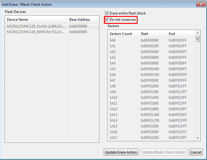

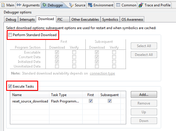

Hello Gerhard,
It looks like some issue in CW download configuration.
If you use Flash Programmer Task for MCU programming, please:
1. ensure that you checked “Do not unsecure” check box in erase action. That will manage, that Flash Configuration Field stay in erased state prior programming.
2. ensure that Debugger will perform either Standard Download or download through Flash Programmer Task – not both simultaneously.
I hope it helps you.
Radek

RadekS
Hello Gerhard,
Radek

gerhardgrasruck
Hello Radek,
sorry for answering late, but there were other pressing issues and we could only now spare some time to revisit this issue.
We have tried out your suggestions and removed additional steps from the Code Warrior flash sequence, which fixed the problem.
So, the issue may be considered fully resolved.
