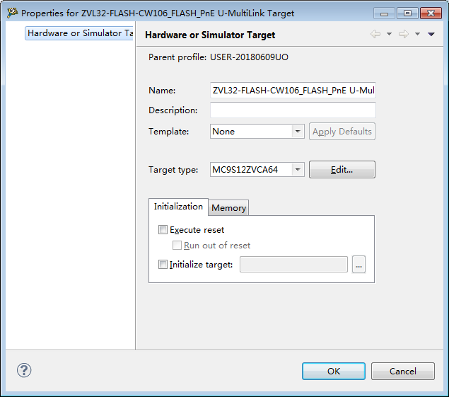

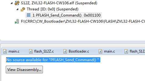

Hi Daniel:
      i have got the same problem, using your attachment(ZVL32-FLASH-CW106); CW10.7 and chip is 9s12zvca64.
when "step over " into the   PFLASH_Send_Command()  program suspended:
the PFLASH_Send_Command() located at :pastedImage_2.png
i only modified the rom range and debug cofigration:
1、How can i solved it ,can you give me some advice!
2、As you said "You should stay in RAM, while it is writing to the FLASH. Without the loop, it immediately leaves your function and starts executing code from the FLASH." what does it mean saty in ram?

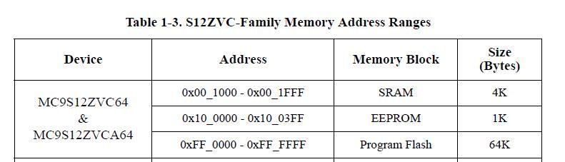

niba
When using "#pragma CODE_SEG RAM" my functions are placed into RAM according to map-file.
MODULE:                 -- fls.o --
- PROCEDURES:
     fls_init                        FF1FE1      20      32       1   RAM
     fls_write_phrase                FF2001      60      96       1   RAM
     fls_erase_sector                FF2061      52      82       1   RAM
- VARIABLES:
     fls_image                         1546      16      22       4   .common
The only think I don't understand, is why the address is 0xFF... and not between 0x001000 and 0x001FFFMemoryS12Z64.jpg
