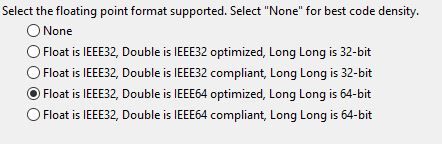

kef2
Senior Contributor V
Did you paste all required options to S12Z Compiler->General->Other flags? It should be like this:
-fp_compliant -double_size=8 -bit64_code_gen mem
-fp_compliant is optional but has to match used *.lib file. But both double_size and bit64_code_gen seem to be necessary to compile long long properly. As well long long constants may need LL / ULL suffix.

kef2
One of 64-bit. I prefer compliant. Won't make any difference if you are not using floating point. Perhaps full printf will drag more code for FP routines.
12,432 Views
kef2
Yes. While creating new project choose one of options with long long is 64-bit
Update:
Looks like I'm using v11.0. Just check if you have options for 64-bits long long in 10.6 project wizard.

shijoabraham
Which one should I select?

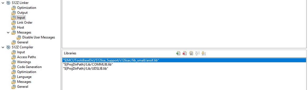

kef2
Yes, possible. You need to change link library in Linker->Input settings. As well add some missing compiler options. You may check which library to choose here:
"c:\Freescale\CW MCU v11.0\MCU\S12lisa_Support\s12lisac\readme.txt"
If not sure create project with right settings, take linker and compiler options, compare and modify them in your work project.

kef2
S12Z Compiler, it should be enough to copy General->Other flags.
S12Z Linker, yes, you should double click on ansixxx.lib and edit lib name accordingly.

shijoabraham
OK. Is it enough to cross check "All options" of S12Z Compiler and S12Z Linker?
And, as highlighted in below attachment, I should change the *.lib according to "floating format" selection.Is itLInkeroption.JPG
