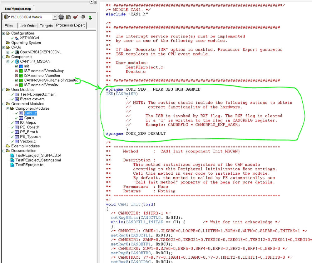

I have attached error file which I am getting while using interrupt , can anyone please provide me solution for it.

See the snapshot below. The ISR inside the pragma segment in CAN1.c source file must be available (out of comment; not in red)
You can use the following code inside the ISR to service the CANRx interrupt:
ISR(CANRxISR)
   unsigned char length, index;
    unsigned char rxdata[8];
    length = (CAN0RXDLR & 0x0F);
      for (index=0; index<length; index++)
          rxdata[index] = *(&CAN0RXDSR0 + index); /* Get received data */
    CAN0RFLG = 0x01;   /* Clear RXF */
Hopefully the info helps.
