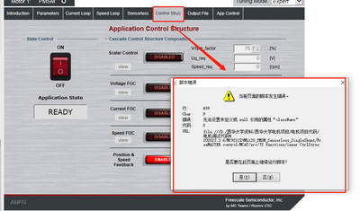

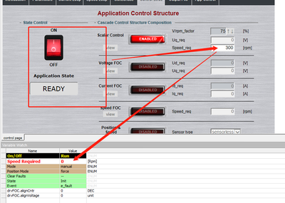

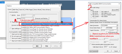

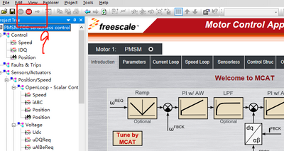

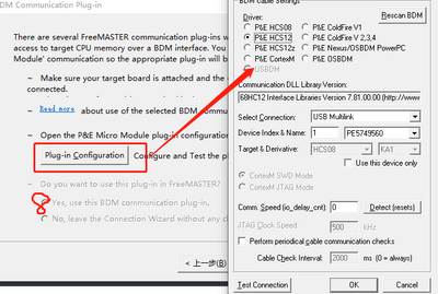

In the process of using MACT, there was an error that could not be solved at present. Please ask for help
1.The starting MACT interface is as follows
2. Start communication configuration. The configuration process is as follows
 It seems that the configuration is normal, and the light with normal communication can also be on
3.However, it finally failed. The following prompt appears, and MACT cannot be used normally
 Software currently used: Freemaster 3.0 Codewheel 11.0

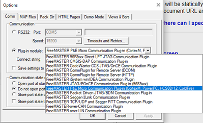

Hi fanlikang,
Please ensure that you exected the right version of FreeMASTER. Go to menu -> Help -> About FreeMASTER
The new FM version will not rewrite the old one and the search at the start menu shows you only one of executable files.
In my case, the list of communication plug-ins looks different:
Just Idea: If you download and install PEmicro Multilink Resource package you may execute the c:\PEMicro\Multilink_Resources\PEFirmwareConfig.exe and check whether your Mutilink probe contains the right firmware for S12Z.
Note: The Mutilink firmware should be updated automatically during flashing code into MCU in CodeWarrior for MCU IDE. The PEFirmwareConfig.exe is way how to do it manualy.
Idea2: You may try install the FreeMASTER Communication driver 2.0 from FM web page
This installation shouldn't be necessary, since driver is already part of example code.
BTW: which S12ZVM motor control software project did you upload into MCU?

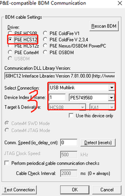

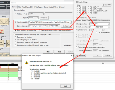

it looks like something wrong in BDM connection.
In the picture 3 you selected HCS12 but you use HCS12Z device. Could you try to change it?

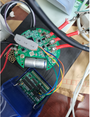

Do you use own board. If yes may I see schematic?

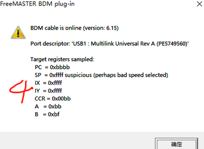

Thank you very much for your patience. Yes, we use our own control board. I have tried to switch HCS12 to HCS12S, but the situation has not improved. It is worth noting that after the change, freemaster does show that the connection is successful, but the variables in the interface have not changed at all. I beg your help.
fanlikang_1-1678261548854.pngfanlikang_1-1678261548854.pngfanlikang_2-1678261589626.pngfanlikang_2-1678261589626.pngfanlikang_3-1678261625673.pngfanlikang_3-1678261625673.pngfanlikang_4-1678261676082.pngfanlikang_4-1678261676082.png
6,388 Views
RadekS
Hello fanlikang,
Thank you very much for these pictures. It seems that the connection works - according to CPU register values.

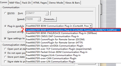

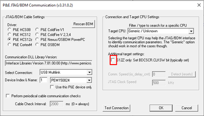

I would like to join my colleague (your FreeMASTER Community thread) in recommending to use newer FreeMASTER version e.g version 3.2.
https://www.nxp.com/freemaster
In this version, it is possible to select a clock for the BDM connection.
Typically the BDM runs on bus clock speed. However, when bus clock is set close to maximum frequency, sometimes there might be some unstability of BDM clock (especially during PLL frequency change). Therefore I would like to recomend to configure BDM clock to fix internal 1MHz oscilator. The BDM connection will be slower, but more reliable. This feature was added also into newest FreeMASTER
According to description, you should uncheck the highlighted checkbox.

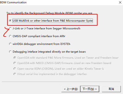

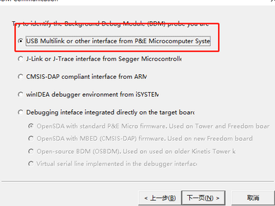

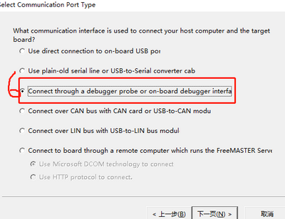

Thank you very much for your patience. Now Freemaster's version number is 3.2. I tried to debug BDM using the method you taught, but unfortunately, this version still does not have the interface you said. I don't know where the problem is.
I have listed my debugging steps in the new version. Please see what is wrong.
Thank you very much for your patient guidance.

       Thank you and your colleagues for their patience. The connection problem has been solved perfectly. The interface of the upper computer can display the value of the variable in real time, which seems to be a small step away from the successful operation of the motor. Thank you very much for your help. If you continue to encounter problems in the process of motor rotation, I hope to get your perfect solution.

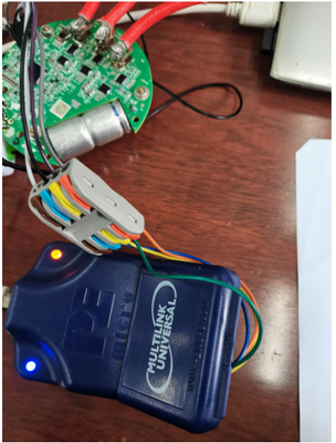

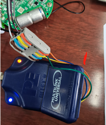

The connection mode of the control board is as follows
