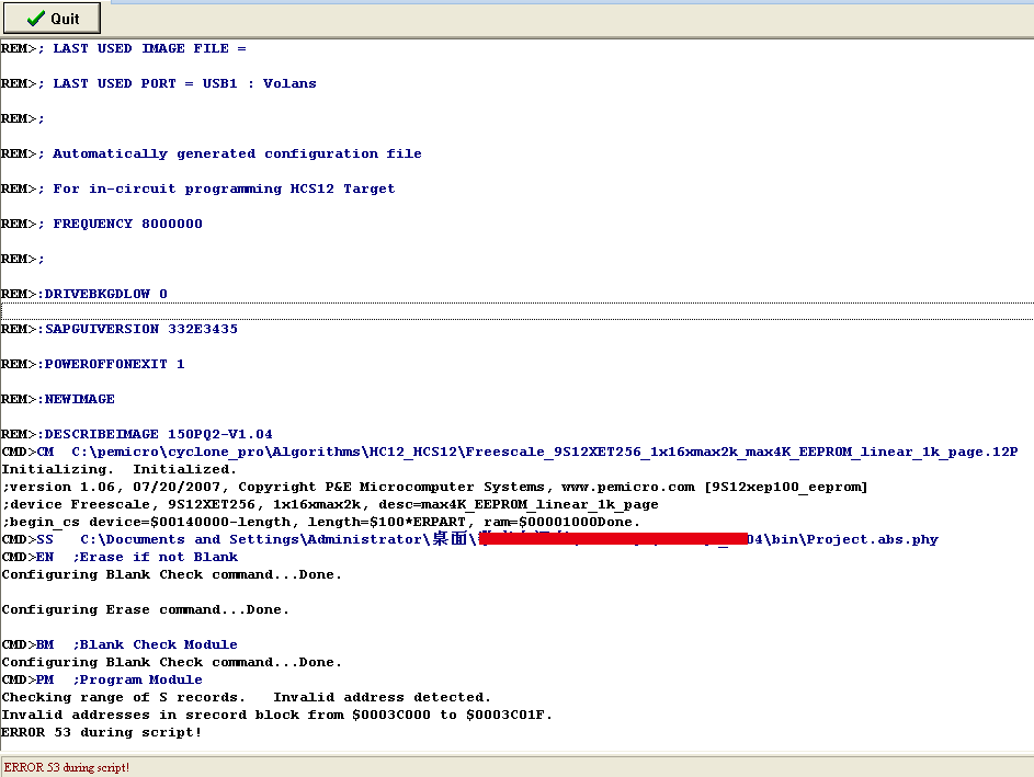

When I store image to cyclone by Cyclone Image Creation Utility Version 3.45,the error 53 reported,Invalid addresses in srecord block from $0003C000 to $0003C01F.
p.s:The MicChip is MC9S12XET256, and the algorithm is Freescale_9S12XET256_1x16xmax2k_max4K_EEPROM_linear_1k_page.12P.
In fect,I've tried every .12P file of 9S12XET256, and allways error.
The details of error as follow picture:

I would like to suggest contacting PEmicro support. I have found two discussions about the same error, see the links below.
http://www.pemicro.com/forums/forum.cfm?forum_topic_id=4120
http://www.pemicro.com/forums/forum.cfm?forum_topic_id=6128
I hope it helps.
