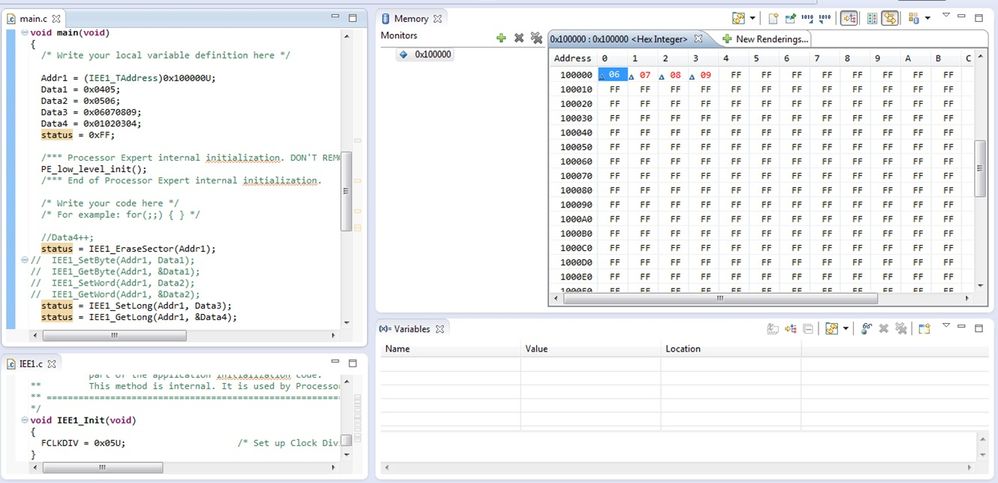

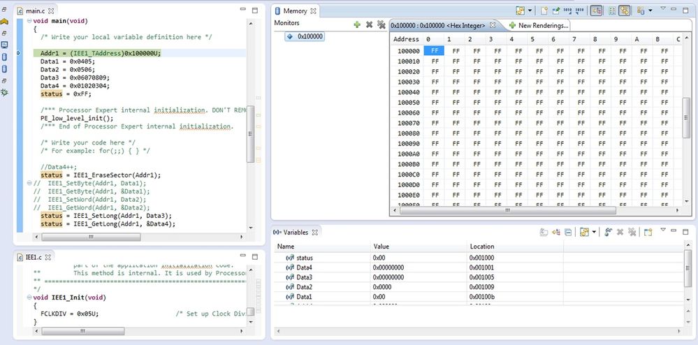

I am working with MagniV MTRCKTSBNZVM128 BLDC sensorless kit, (MCU part no S912ZVML12 MKH). My requirement is to program EEPROM memory. I am able to program the EEPROM sector but after Power reset or when code is flashed again, EEPROM is set to default data i.e. FF.
From Pic 1 you can see that 06, 07, 08 and 09 is written but when I downloaded the code next time EEPROM get sets to FF (see Pic 2).
I want to see the updated data on EEPROM even after re-downloading or power reset.
Please let me know possible reasons and solution for this.

Hi there,

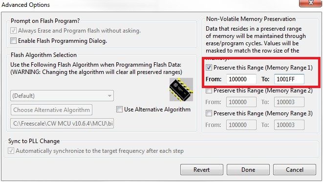

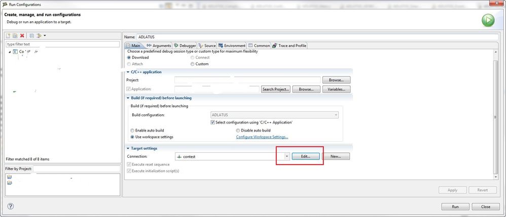

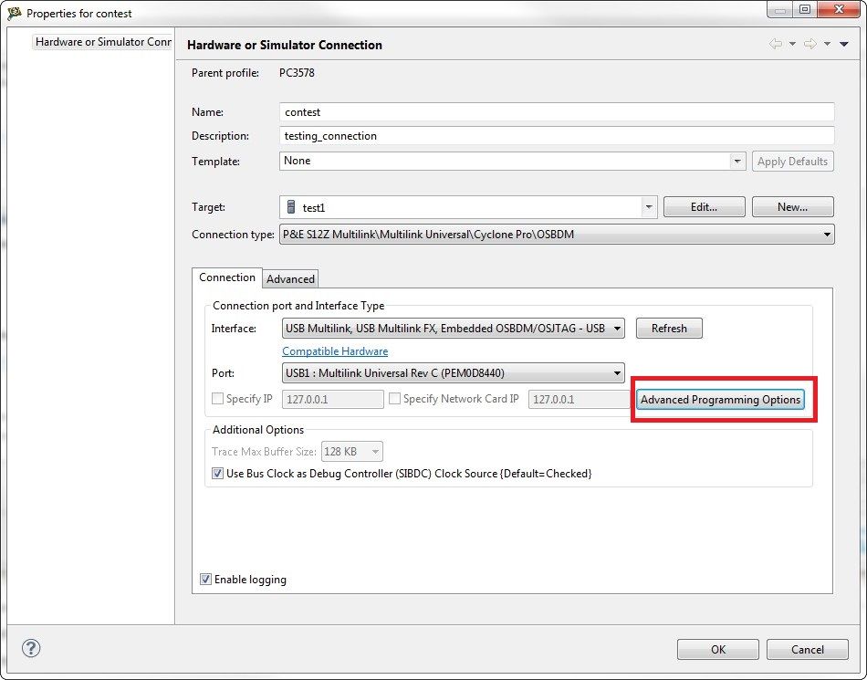

have you tried to specifie a "preserve memory area" in your RUN/DEBUG configuration?
Go to: Run -> Run Configurations -> Target settings: Edit -> Connection: Advanced Programming Options
(See attachet pictures for a hint)
There specify the address range of your eeprom. I did this in example for an s12zmvc128. For your target CPU it might differ, so check the manual.
Why your eeprom gets reset after a Reset i have no idea, may be some init routine or some fault correction if you use an automated CRC in your project. Maybe try the preserve memory are and see what happens next.
Hope it helps
Kind Regards
Clemens

Hi Clemens,
Thank you very much, issue is resolved.
Able to write and save the previous data on eeprom :smileyhappy:

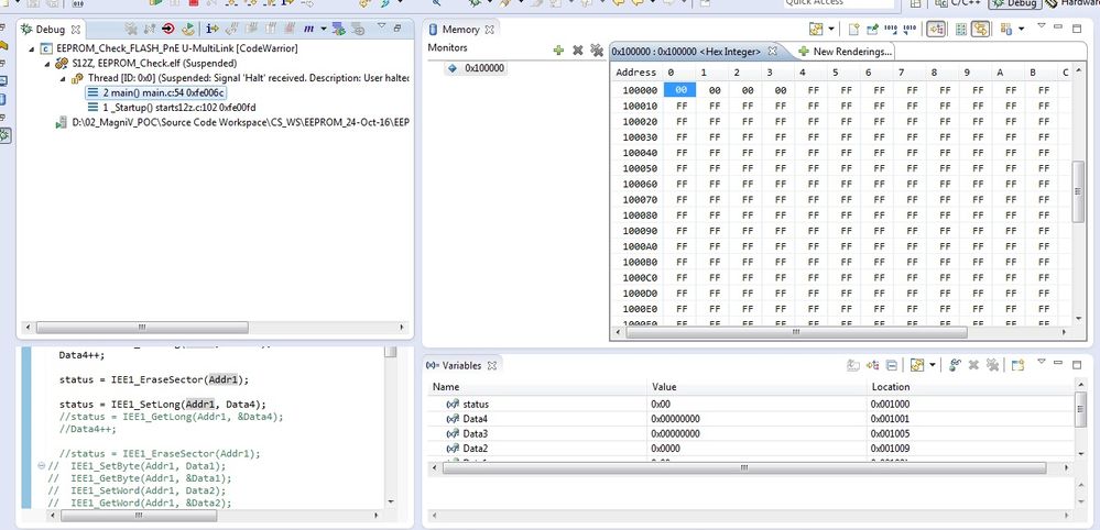

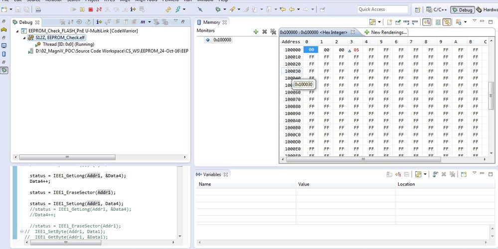

rajkumarwadhwan
Hi Clemens,
Yes preserving the memory works, Thanks a lot for your solution. I can see the last written data even if I re download the code.
But now issue is with Power reset. After power reset EEPROM sets to 00. Find below snaps for your reference.
Please let us know the possible causes and solution.
