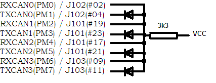

I am thinking of a new product that uses two S12XE. One MCU will be a slave and read sensors. The main MCU would either request the information from the slave or receive it when is ready. I have done this in the past using SCI. I am looking at using CAN Bus to communicate.  Do I still need CAN transceivers, or can I just connect the low level signals from the CAN pins.
I am open to ideas using some other method.

Hi Ray,
Edward is right.
You don’t need transceivers. For short length communication, diodes and pull-up are sufficient solution.
Here is simply scheme for connection of four CAN modules together at DEMO9S12XEP100 board as inspiration for you:
Tested and proved.
I hope it helps you.
