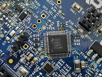

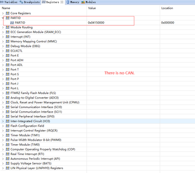

I am using the DEVKIT-S12ZVL.      I downloaded the example from NXP.com .  The example is ZVL32MLF, and works ok.     The part ID is 0x04150000.     But the picture is S9ZVL12MLF.
So  is S9ZVL12MLF  ZVL32MLF or ZVLA12MLF?
The difference between the two chips is that one consists of CAN and the other does not have CAN.
Thanks.

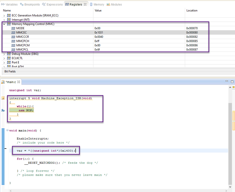

You can read SRAM at 0x1400 which is unimplemented on S12ZVL32.
If Machine exception rises, the part is S12ZVL32

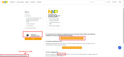

Regarding the download link, thank you for pointing it out, let me report it.

I think the S9ZVL12MLF is ZVL32MLF.    So I plan to buy s9zvl128mlf development board.
But there is a wrong code download link.

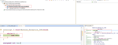

nujia
Hi , Daniel,
         Thank you,   It runs to the Machine exception ISR.  So it is S12ZVL32.

danielmartynek
Hello @nujia,
Can you show a screenshot of the ID register in the memory view?
