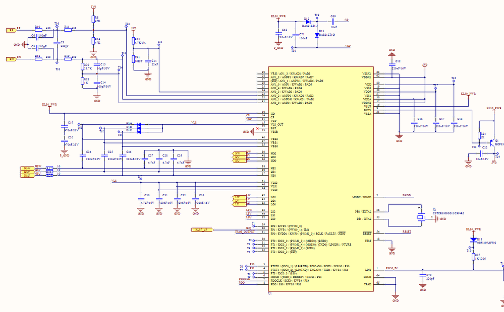

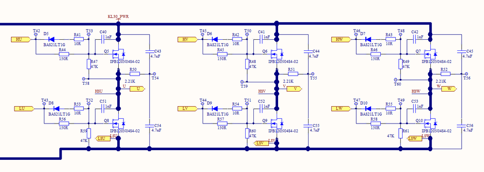

chdingding
I download the source code from NXP website,
so as to motor can be started,  at first  #define ADVANCE_ANGLE  FRAC16(0.4815),
and another macro define :#define ADVANCE_ANGLE1 FRAC16(0.08),
when the motor speed reach the certain speed, i want to let the motor‘s speed much faster,so we will let advanceAngle decrease ,judge
if(advanceAngle>ADVANCE_ANGLE1)
   advanceAngle-=2;
when ADVANCE_ANGLE < 0.12 , GDUDSE ERR will appear.
i don't know where is wrong, and how to correct it.
below figure is my Schematic,

Since your issue cannot be experienced with our devKit/EVB, I assume it would be connected with your HW. Have you checked the drain-to-source voltage of the MOSFET indicating the desaturation? If it is below 1.4 V, then you would need to check the HD pin or phase pins for peaks or ringing. If that would be the case, you can try to adjust the blanking time or implement a HW filter (RC-filter) to these pins.
Matej
