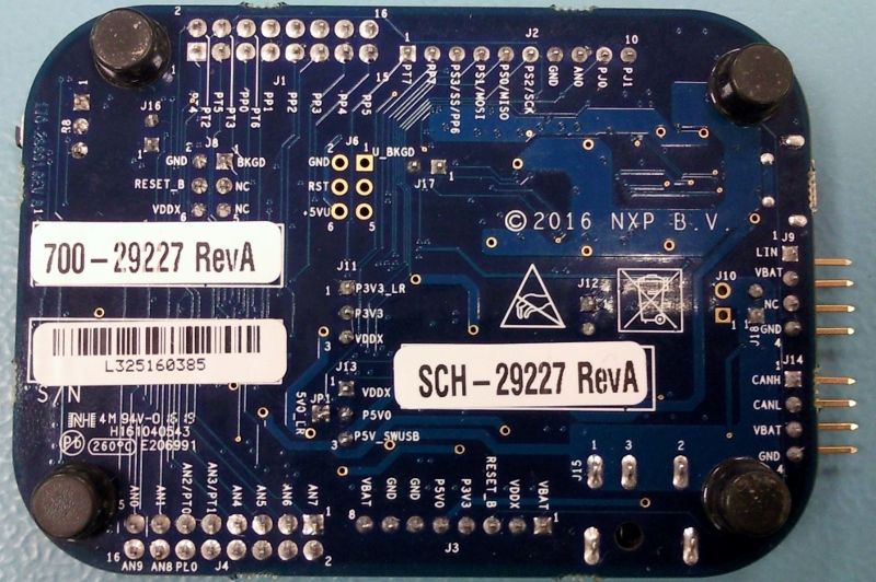

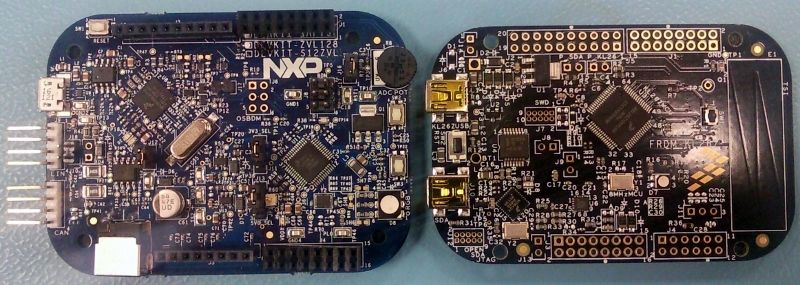

The DEVKIT boards are similar to FRDM boards, but they are slightly wider (58mm versus 53mm) due to moving MCU specific pins to external rows of Arduino pin compatible connectors. So, we should be able to access MCU specific pins even when we connect any Arduino shield on top of this board.

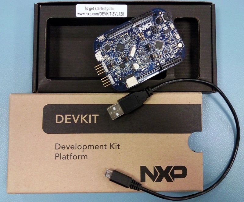

What you will get for US$35 (current price on NXP web pages):
  • Antistatic paper box
  • DEVKIT-ZVL128 board
  • short micro-USB cable
The sticker on the box points to the NXP web pages for downloading more documents such as the quick start guide, schematic, PCB BOM and design files, code examples or buy the same board again ;-).
Unfortunately, the board User Guide is not available yet.
This web page is also offering “Getting Started” tab with the interactive quick start guide – quite useless feature since the page forgets on necessary 12V power supply for MCU powering and it proposes old CW5.1 (Classic IDE) for S12(X) instead of CW10 (Eclipse IDE).

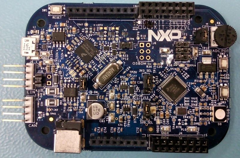

DEVKIT-ZVL128 board is assembled by:
  • S12ZVLA128 MCU (Big Knox) in 48-pin LQFP package
  • 8MHz crystal
  • Standard 2mm DC power jack connector for 12V power supply
  • On-board OSBDM debugger trough micro-USB connector
  • Standard BDM connector
  • Arduino UNO pin compatible connectors with extended connectivity (the internal rows of the connectors are arranged to fulfill Arduino™ shields compatibility)
  • RGB LED and 2 x push button switches
  • LIN and CAN connectors
  • CAN transceiver MC33901
  • 5k potentiometer and RESET switch
  • 3V/150mA and 5V/150mA LDO voltage regulators
The great thing is that the board has connector pins named from the bottom side of the PCB = less tracking on schematic.

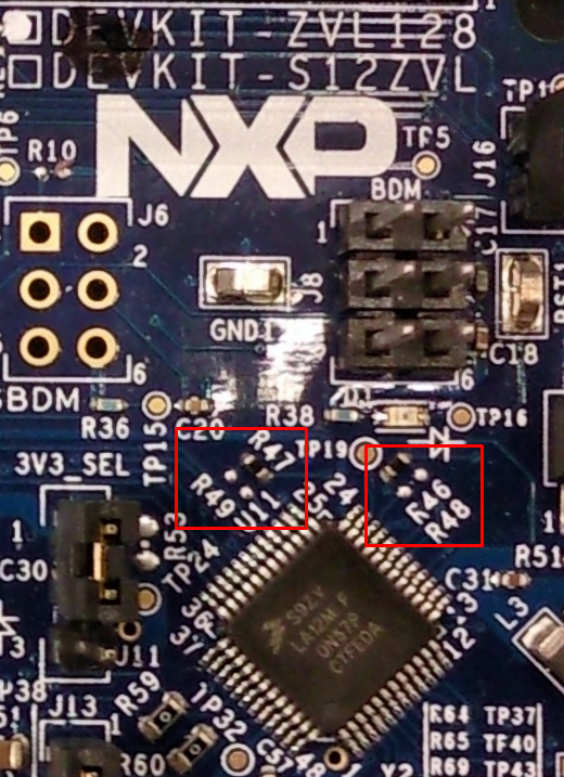

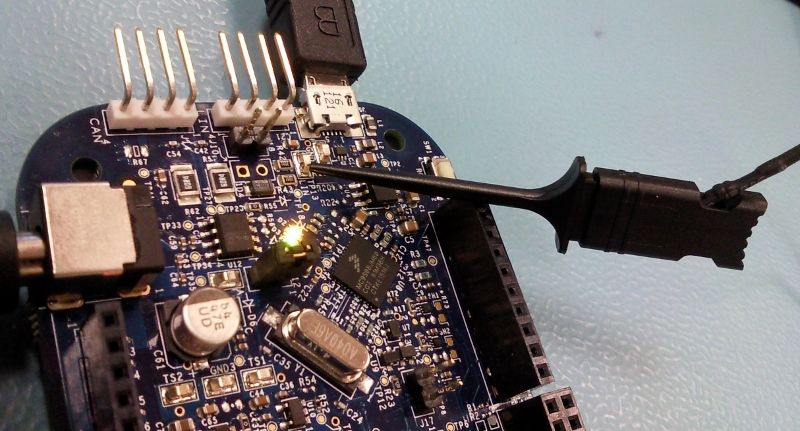

On another side, some of the MCU pins may be routed to Arduino connectors trough zero Ohm resistors. Since these resistors are very small (size 0402), the potential re-routing will need a solid hand.

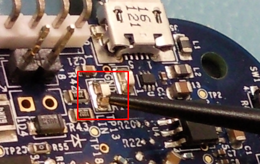

It is great that loop type test points arrived finally also on low-cost development boards – now in surface mount version. The small loops may be simply locked by test hooks and measured by laboratory equipment.

You mention a "12V DC power supply (3.8V~40V) with barrel connector (6mm outside diameter x 2mm inside diameter)" is needed. Can the board also be powered by USB?
My guess is yes as the schematic shows a 'Power Supply Selection section with jumper option to P5V_SWUSB' .
Therefore I tried setting the jumper 13 between 2-3 but no connection 'Target MCU is not responding'. Measuring their is no power on J13 Pin3. This makes me believe MIC2026-1YM is not enabling OUTB because ENB is not powered. (Measuring proves this hypothesis). Why is +VTRG_ENB not enabled by MC9S08JM60CGTE?
Or am I misunderstanding jumper 13?
Hi Peter,
Unfortunately, the DEVKIT-ZVL128 board cannot be directly powered from USB.
The assembled S12ZVL128 MCU is part of MagniV family which is designed for powering directly from 12V line. So, the 5V from USB is simply not sufficient for MCU powering.
Note: The S12ZVL128 MCU may be theoretically directly powered from 5V power supply connected to the VDDX/VDDA pin (MCU is not designed for such use). However, in such case we must connect also VSUP pin the same power line for avoiding any issue with transient effects. Such connection will also disable main features of this MCU(integrated power supply, internal LIN PHY,…)
Yes, the 'Power Supply Selection section with jumper option to P5V_SWUSB' is just misunderstanding.
The jumper J13 (+JP1) choose one of source power supplies (MCU, USB, U13 voltage regulator) only for on-board CAN transceiver and Arduino-Uno compatible J3 header. The output from J13 jumper is P5V0 signal.
I hope it helps you.
Best reagrds
Radek
Hello Radek,
Thanks for the clear explanation.
Do you know if this is somewhere documented?
I have found the quick-reference-guide/DVKITZVL128QSG.pdf but this only suggests the opposite:
"CAUTION:
               When powered from the USB bus, do not exceed the 500mA maximum allowable current drain. Damage to the target board or host PC may result."
Hi Peter,
Thank you for notification. I reported this issue almost two years ago.
It seems, that nobody fixed it until now.
I will report it again.
The issue is related to QSG and Getting Started page also …
There is just simple Note on the board web page “12V (1 Amp) power supply is required for debugging and CAN/LIN communication, this is not included in the kit”
https://www.nxp.com/support/developer-resources/hardware-development-tools/ultra-reliable-mcus-devel...
Radek
