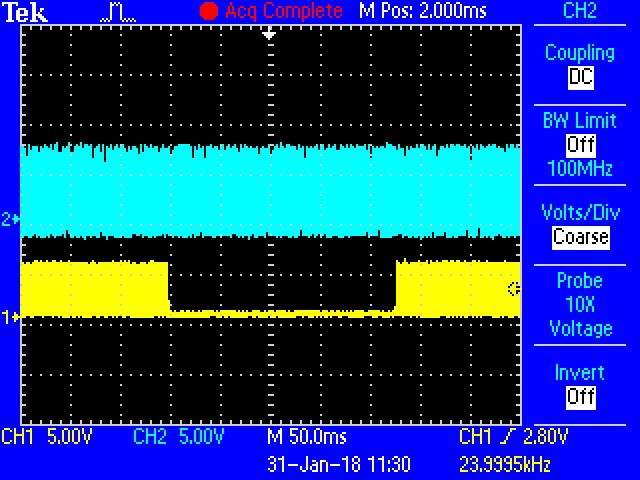

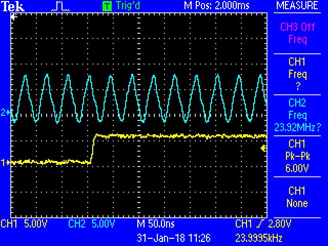

robertwynn
  I have monitored ECLK it looks fine. The board does not restart.  Here are a few scope plots.
Robert

danielmartynek
Hi Robert,
Thank you for the plots.
Have you tried running only the code you posted?
The PWM1 function of PP1 has highest priority, so the PWM module controls the pin if enabled.
Unless it is embedded in a project where you could accidently disable the PWM.
Could you halt the program when the PWM is stopped and check all PWM registers?

danielmartynek
Hi Robert,
I have just run the code on TWR-S12G128 and everything works. It doesn't stop.
Could you monitor BUS clock on ECLK?
