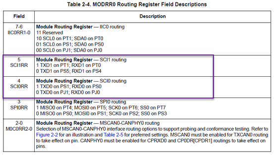

1. How many LIN communication functions do we use?
2. If possible, please provide the port number of the feature.
784 Views
danielmartynek
I'm not sure if I understand.
S12ZVC MCUs do not have any internal LIN Physical Layer unlike S12ZVL.
But there are two SCI modules
