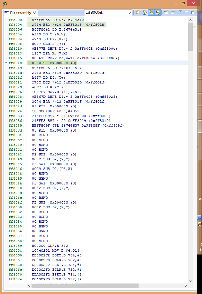

If the pointer APPLICATION_START_ADD points to main function of application, everything works well.
If the pointer APPLICATION_START_ADD points to the beginning of flash of application, it jumps to Start-up Code of application. After executing function DoZeroOut, it returns to the programm of bootloader (line FF8018). The function DoCopyDown or main of application below will not be executed.

You are right, the linker place DoZeroOut() function as the first object in the flash by default.
Unfortunately, I didn’t found till now any direct way how to simple place _Startup code on Flash start address. I suppose that there is some nice solution, but I am not sure now where.
I created “simple” workaround:
I just placed additional code at Flash start address which contains just jump to the _Startup entry point.
This solution (rather say workaround) takes 4 bytes from Flash and 1.5 bus cycles of execution time.
Please look at the example of modifications in attached application prm linker file.
Note: I didn’t test it with bootloader yet, I just checked generated *.sx file. Please take it as a source for your inspiration.
Note: I suppose that Application never ends (except reset). In opposite side, we have to use JSR instruction (0xBB) instead JMP for stacking return address and we cannot reuse Bootloader RAM content in the application.

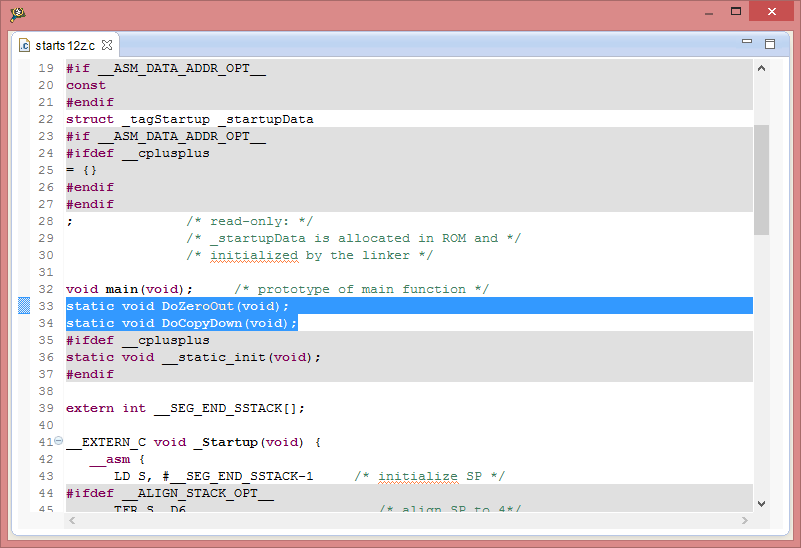

I did change startup code a little bit with function prototype and _Startup function is always at the top of Flash.

You are right, you found it (change order of DoZeroOut(), DoCopyDown() and _Startup() functions in starts12z.c file).
I tested this approach yesterday as first, but it didn’t work on my side. Now it works.
