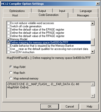

The S12XE has a neat feature that allows the lower fixed page of Flash (0x4000 - 0x7fff) to be replaced with RAM. This allows access of 24K of contiguous RAM in the local map from 0x2000 - 0x7fff. Setting the ROMHM and RAMHM bits in the MMCCTL1 register will replace the Flash with RAM.
The RAM segment definition would change to:
RAM           = READ_WRITE    0x2000 TO   0x7FFF;
In the compiler options you would need to set the 'MAP' option as shown here:
I believe setting this option will automatically set up the MMCCTL1 register in the startup code, but you should check.
You also need to make sure that a segment definition for Flash in the 0x4000 - 0x7fff area does not exist in the .prm file.
Note that this does not require the use of the Large memory model.
Hope this helps.

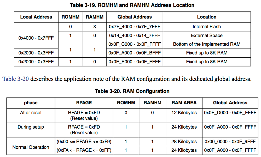

nice idea with RAMHM, but RAMHM=1 bit description tells this
  • Accesses to $4000–$7FFF will be mapped to $0F_C000-$0F_FFFF in the global memory space (RAM area).
If this is correct, then 0x2000..0x3FFF and 0x6000..0x7FFF should be identical instances of the same physical RAM. So not 24k, but only 16k, right?
With RAMHM=1, fixing RPAGE to 0xB it is possible to have contiguous 20k RAM at 0x1000..0x5FFF.
Edward
4,749件の閲覧回数
GordonD
Edward,
No, there is 24K of RAM available in the local map from 0x2000 - 0x7fff and if the RPAGE window isn't needed to access the remaining RAM (it could still be accessed via GPAGE addressing), a total of 28K is available from 0x1000 - 0x7fff if the RPAGE register is set to 0xf9 and not changed. Take a look at these two tables from Section 3.4.2.5, Memory Configuration, of the MC9S12XE-Family Reference Manual Rev. 1.25:
