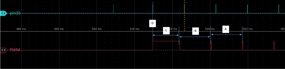

Xuqq
Hi Daniel,
Thanks for your reply.The waveform is as follow:
Cycle A (second cycle)is right PWM, with a cycle of 10ms and a duty cycle of 2%.
Enable PWM for the first time at D, in the first cycle, a waveform of B + C appears.
I think there should be only B but no C.
In addition, clear the counter register before enabling PWM, the waveform is correct.
Could you tell me why is the duty cycle register buffered?
I know this register is double buffered, but I don't know what it means to be buffered.

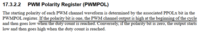

danielmartynek
It is explained in the RM shown below, basically, it allows changing the duty-cycle at the end of the period (typical use case) not at the time the register is written.
The polarity bit is set to 1, right?
Since it is double-buffered, and the last value is 0, it does not go down in the first cycle.
You need to synchronize it by writing 0 to the counter.
BR, Daniel

Xuqq
Hi Daniel,
Thanks for your help. The polarity bit is set to 1. Writing 0 to the counter register can solve this problem.
