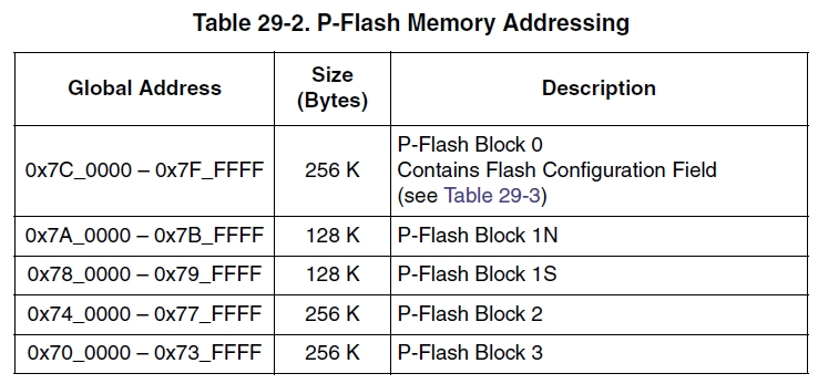

  • You can see the address is different, one is 0x7XXXXX, and one is 0xFXXXXX.
0x7XXXXX is global address, while 0xFXxxxx in PRM is banked address.
Banked address PPAGE * 0x10000 + offset to PPAGE window. For example PPAGE 0xFD, offset 0x9ABC, banked address 0xFD9ABC. And global address is PPAGE * 0x4000 + (offset % 0x4000) + 0x400000. The same banked address translates to global 0xFD * 0x4000 + 0x1ABC + 0x400000 = 7F5ABC. This applies only to flash. RAM and EEPROM address translation is different.

Also I have another question:
I found the P-flash address is different between 《MC9S12XEP100MAG 》datsheet  and  《Project.prm 》, the 《MC9S12XEP100MAG 》 datsheet  say:
But the 《Project.prm 》show:
PAGE_F8       = READ_ONLY   DATA_FAR IBCC_FAR  0xF88000 TO 0xF8BFFF;
      PAGE_F9       = READ_ONLY   DATA_FAR IBCC_FAR  0xF98000 TO 0xF9BFFF;
      PAGE_FA       = READ_ONLY   DATA_FAR IBCC_FAR  0xFA8000 TO 0xFABFFF;
      PAGE_FB       = READ_ONLY   DATA_FAR IBCC_FAR  0xFB8000 TO 0xFBBFFF;
      PAGE_FC       = READ_ONLY   DATA_FAR IBCC_FAR  0xFC8000 TO 0xFCBFFF;

Regarding the last question, please see the attached memory map.
There a difference between a global address and a paged address.
