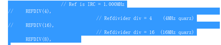

Hi, Bro
We use DEMO CODE:RD9Z1_638_12VLA_DEMO on MM9Z1638 Borad  to test msCAN  interface,and we don't placed a Oscillator,
so I modified two places:PICTURE 1
but I can't get correct rusult,500kbps,
actually get 833.3kbps  PICTURE2。
Is there some thing has to set,or make some mistakes。
                               THANKS FOR YOUR HELP

-what hardware do you use KIT9Z1J638EVM?
-CAN will require an external oscillator to achieve the required CAN clock accuracy
-the CAN bit timing (time quanta, etc.) is set in the msCANcfg.h file:
* Define msCAN module clock source: BUSCLK or MCGERCLK
* Permitted values: BUSCLK:   Bus clock is used as clock source
*                   MCGERCLK: Oscillator clock is used as clock source
#define CLKSRC_CAN0 MCGERCLK
* Define clock prescaler for msCAN module: permitted values 1 to 64
* msCAN module clock = CLKSRC_CAN / PRESCALER_CAN
* Set different Prescaler for all CAN Channels, in case the Oscillator Frequency is 8M
* Note: User can carefully change this part to get different bitrate
//#define PRESCALER_CAN0          (1)       // 1000kbps, if CANBTR0 AND CANBTR1 IN the driver not changed
#define PRESCALER_CAN0          (2)       // 500kbps, if CANBTR0 AND CANBTR1 IN the driver not changed
* Define msCAN module bit timing
* Permitted values:
*                   PHASE_SEG1_CAN: 1 to 16 time quanta
*                   PHASE_SEG2_CAN: 1 to 8 time quanta
* Bit time = (1 + TIME_SEG1_CAN + TIME_SEG2_CAN) * time quanta
#define TIME_SEG1_CAN0          (7)
#define TIME_SEG2_CAN0          (8)
* Define msCAN module re-synchronisation jump width
* Permitted values: 1 to smaller of 4 and PHASE_SEG1_CAN time quanta
#define RJW_CAN0               (2)

Thanks for your helps.
      I adjusted the one paramete,
 and now  I can send data from the CAN bus, through CAN- Monitor connected PC, PC can get the correct data, however, PC sends data to the board, the board can't receive PC data ("SET FRAME ID: 0x10"),   can't get   "NEWDATA" ,
I use the oscilloscope to test the TX and RX pin on board, oddly, TX and RX when sending data have the same waveform.
I don't know where's wrong.    Can you give me some advice, or an example.

ztzzzttt
THANK YOU FOR YOUR HELP!
I have set 800k Baud and goten RX and TX correct data 。thankyou!
