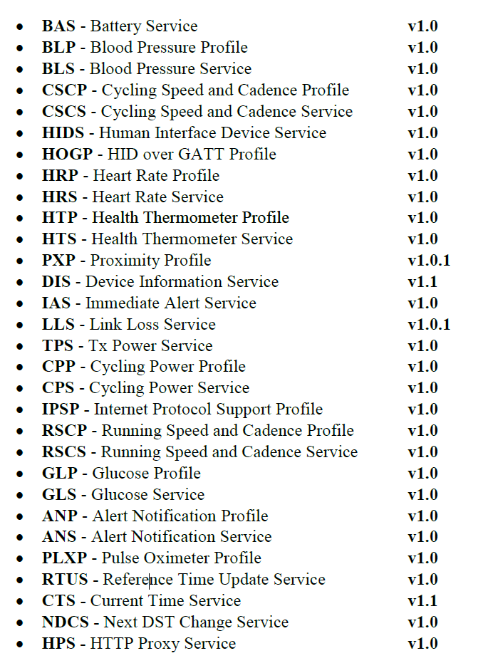

stephanie_m
The supported Bluetooth LE profiles supported by the KW41 (which it's the one in charge of the Bluetooth in the rapid IoT)  are the following
You can check this posts
Rapid IoT Studio Project Example: Smart Air Conditioner
https://community.nxp.com/docs/DOC-342109
And maybe you could try developing your custom profile can help you with this to create something like the wireless uart example, but you will need to verify if this is possible to be done in the Rapid IoT.
