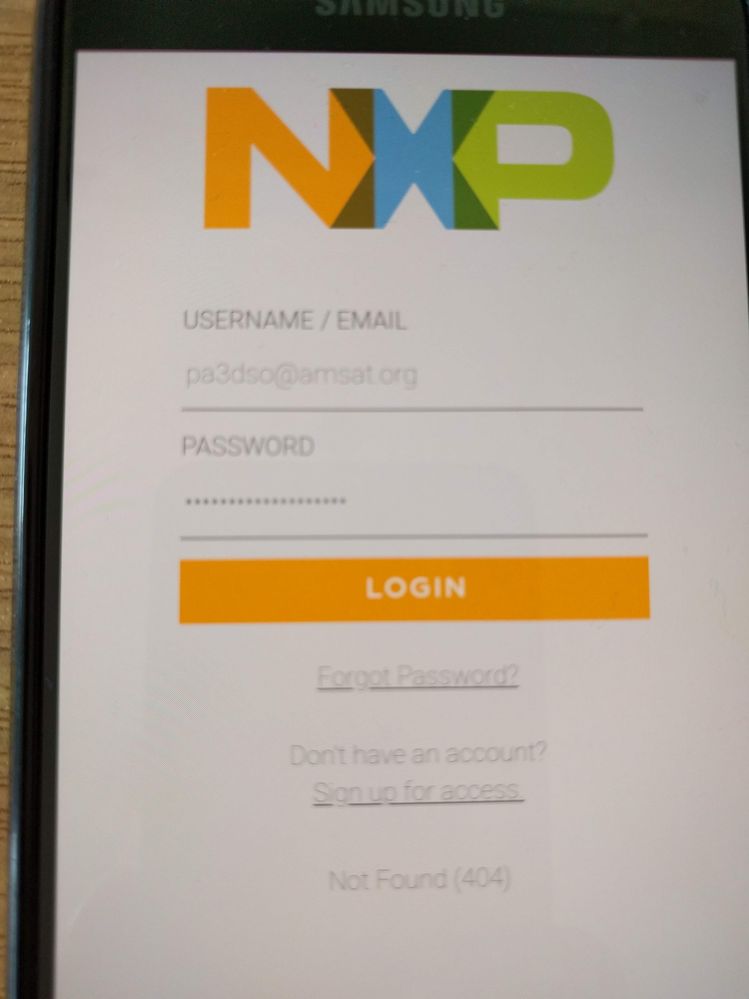

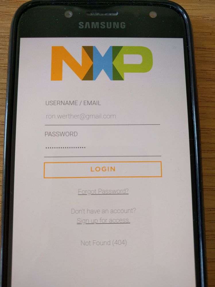

Hi Richard,
I included the pictures again.
So both accounts wont work on Samsung using the newest App from G-playstore.
Then sometimes the screen shows RELOAD and ask again for username/password.
regards Ron

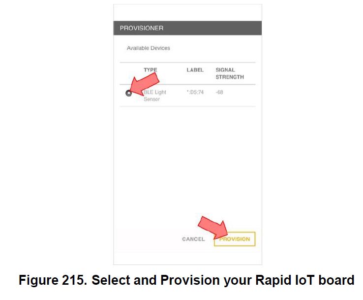

Eric_Ma
Hi Ron,
The log you provided looks ok, except that there is no indication you tried to connect via BLE. Looks to be a normal log for the boot sequence.
I would like you to capture the log during provisioning and BLE connection.
In the mobile phone application got there:
and tap either the top right icon or the ' + ' in the middle of the screen, then selcet your kit and provision it.
This will/should trigger:
[NFC] Registration Set                                    <=== This is where you stopped
GAPConnectionEventConnectedIndication   <=== Here he BLE phone connection ' request"
Error opening file ble_enabled
Error opening file thread_enabled
GATTServerCharacteristicCccdWrittenIndicationGetting char for CCCD handle 0B
GATTServerCharacteristicCccdWrittenIndicationGetting char for CCCD handle 15
Handle: 04 Notifications: 1 Indications: 0
Authenticating...           <=== This is the provisioning step, making sure your kit is authentic before connecting to phone / cloud.
GATTDBFindCccdHandleForCharValueHandleIndication <=== Here BLE connection actually  'starts'
Handle: 04 Notifications: 0 Indications: 0
[BLE Provision] RX CMD 01
Extra Settings: 01
[BLE Provision] RX CMD 0B
[BLE Provision] RX CMD 0C
[BLE Provision] RX CMD 02
I need the missing part of the log to figure out what is the potential root cause.

pa3dso
Hi Eric,
I will try but I am stucked when I am requested to login in the app, so I wont get the screens you showed.
"But since I cannot connect anymore to https://rapid-iot-studio.nxp.com/
I was not able to get it running on a newer phone yet. Just can't login.
Can you help me on this one too? I deleted the original account on the development site, but I cannot get it running it back on again. I tried several attempts to register with different accounts.
It wont send me a confirmation message to accept the account.

pa3dso
Hi Eric,
I used another laptop, another  account and another browser (first chrome now FF) to recreate a new IDE environment on my laptop. The acceptance message came directly. I reset the device to factory.
So I can connect to the IDE.  This works so for far with this laptop and FF. In the IDE the IoT device is not recognised in this new setup. The icon "add device"is not displayed. so no provisioning can be performed.
I am not able to connect using the same user and passwd via de RIoT app on my smartphone and so no provisioning via this way is possible. also after reinstalling this app I get the "message not found (404)".
Not able to connect to the UART anymore via tera term either.
NO "Mass storage attachement" works anymore.
Perhaps I need to flush some caches and etc. Where can I start.??
Finally removed the (beta) app from smartphone and installed an older version (1.1.4) as found in one of the earlier posts.
