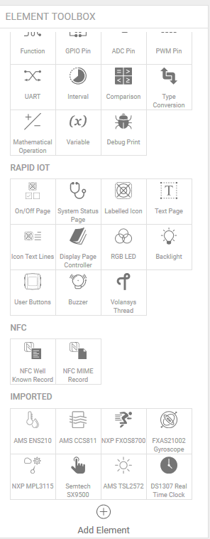

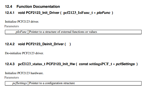

I see PCF2123 RTC functions are described in the SDK API, but there is not an object available on the on line IDE.
Is there a plan to implement the RTC object ?

Well, as you mentioned I only see an element for RTC is DS1307, not sure if any plan to add element &demo for PCF2123. I will check with the IOT team.

marcomerlin
I was just shown that Atmosphere provide a way to create your own elements, as described here Importing Elements .
On top of that I was told the RTC element is used by the OOB demo somehow - however I do not understand how the code was developed then.

marcomerlin
In the rapid iot studio ide on-line
https://rapid-iot-studio.nxp.com/
there is no PCF2123 "item"
However the functions are available in the MCUXpresso SDK, according to the API SDK user manual
