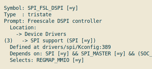

kai_wu
Hi YIping,
Thanks for the device tree you provided. It works for me.
Also, I enable the fsl-dspi module in linux menucofig.
Test results (send:121212121, receive 121212121):
