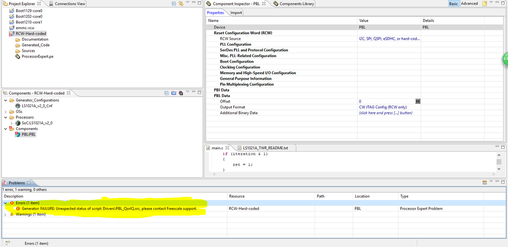

I am trying to follow the reference manual 4.4.6.2 to create my 0x9A hard coded RCW settings for my ls1021a stand alone board. After I follow the recommended settings and regenerate the code it shows me an error below:
Can anyone help?

Hello Elias Bitbaker,
I didn't reproduce your project, please refer to my attached workspace.

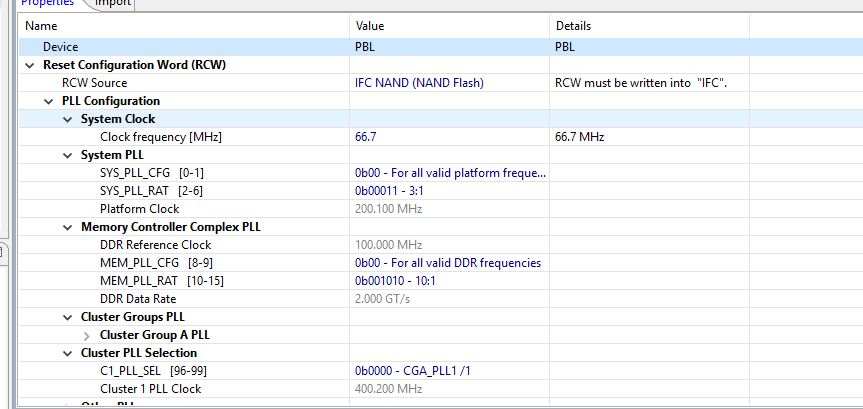

your work space i load your PBL.bin file but it shows
IFC NAND (NAND flash) shouldn't it be eMMC
also if I want to use 0x9a hard coded option the clock should be 100 MHz right ?

yipingwang
On my side, the system clock frequency is 100MHz, please import the project form File->Import->General->Existing Projects into Workspace.
