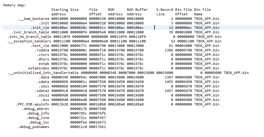

the map file is this,which is the ram size?the .map file is in the accessory.

Usually memory configuration file contains information about RAM size. Check your project configuration.
NXP offers CodeWarrior 10.5.1 for QorIQ processor:
https://www.nxp.com/support/developer-resources/software-development-tools/codewarrior-development-t...
This CodeWarrior uses .tcl file for hardware initialization and .mem files for RAM size.
