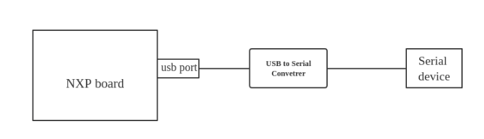

Recently, I connected a serial device to the NXP board, which is LS1012ARDB,  see the figure below.
after plugging in the serial device to the NXP board, the output of dmesg[1]  is shown below
new USB device is detected but the serial device is not attached. Also, no new device name appeared
under /dev. I tried to use minicom[2] to connect ttyS0, ttyS1....ttyS3, all of them failed, I got no
response from them.

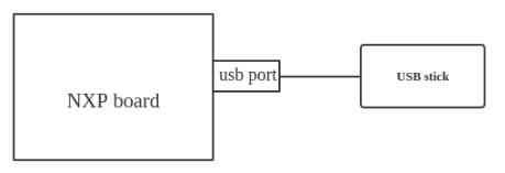

But when I plugged in a usb stick into NXP board, see diagram below. The usb stick is successfully
detected and attached, a new device name was created under /dev.

Is USB Serial converter support enabled in kernel menu for your board?
For example see attached snapshot from LSDK 1809 kernel menu.
This menu is available using the following in kernel menu:
   Device Drivers  --->
                [*] USB support  --->
                               <*>   USB Serial Converter support  --->
