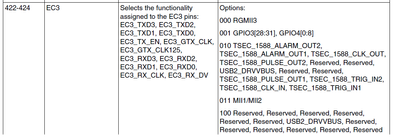

I'm trying to toggle gpio3_31 pin through sysfs in the ls1021atwr board.
I tried export 1 > gpio47/value
but the value remains 0, do I need to change the rcw configuration in u-boot?

I'd like to modify the rcw image without using codewarrior can you please suggest which field to modify and what value to be added

Please configure RCW[EC3] (422-424) as 001.
Please refer to the following from LS1021A Reference Manual.
