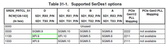

Iam working on custom card based on LS1046a Processor. We have connected two identical SFP+ connection(XFI1 Retimer with SFP cage) to Lane 0 and Lane 1 SERDES1 Module . (RCW value = 0x1133)

But linux is detecting fm1-mac10 as SFP+ connected to Lane0 of serdes module. I am able to ping to this.
There is no signal /frame on SFP+ connected to Lane1 of serdes module.
Both of SFP+ modules are similar to each other and similar to LS1046ARDB Kit.
Kindly Help.
How this could be considering that XFI.9 is on the lane 0?
It is connected to Lane1 of serdes module. fm1-mac10 is okay
The other SFP+ is connected to lane0 of serdes module and it is not working. We are not able to see any signal/ frame on this SFP+ connector.

Please use CodeWarrior QCVS SerDes Validation tool to check the lane 0 integrity.
