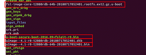

We attach the image name what we use, boot script, and console window screen shot.
This is name of each image we use.

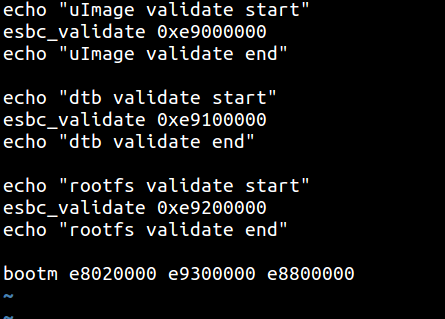

This is bootscript.
We make this bootscript using mkimage.
command is as follows:
~./mkimage -A ppc -T script -a 0 -e 0x40 -d bootscript.txt bootscript

It looks like that your "bootm" command contains incorrect address for root file system.
Test your script if manually set commands from this script.
