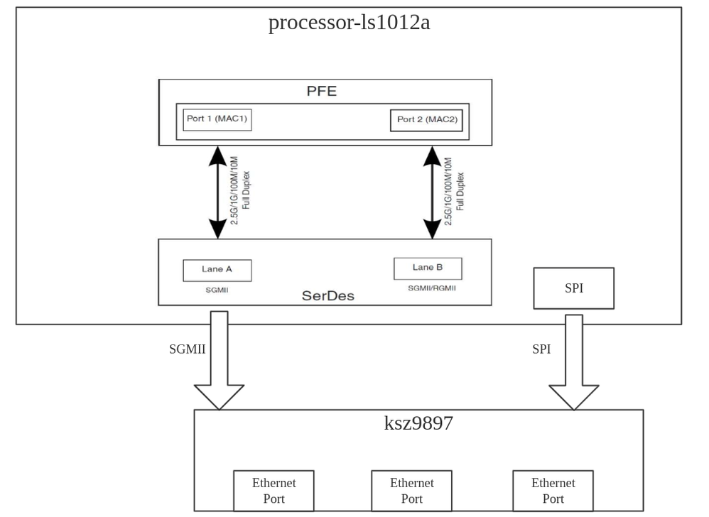

I am using Mainline Linux 5.1 on my board (with ls1012a).  See the Figure 2 below.
I prepared the device tree for PFE, ksz9897(an ethernet switch) and PFE.
Also the driver for ksz9897(spi), fsl-dspi is enabled in Linux kernel.

Figure 2. Connection between ethernet switch and ls1012a
I tried to port fsl-ppfe into mainline Linux 5.1(copy the fsl-ppfe folder from NXP Linux 4.19 into the mainline linux 5.1, make changes in drivers/staging/Kconfig and drivers/staging/Makefile). But when I am trying to compile this mainline Linux 5.1, I met many errors about the PFE driver( It seems many header file included by ppfe is changed in mainline Linux 5.1)?

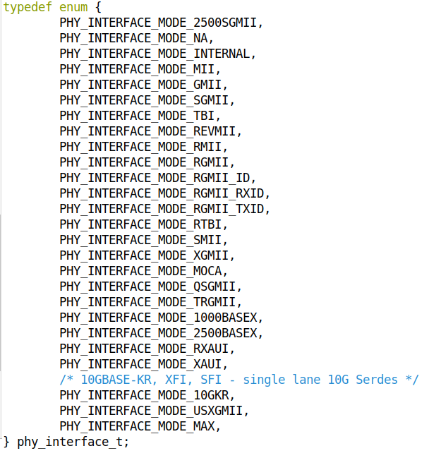

When I tried to compile the Linux kernel 5.3. It shows an error in fsl_ppfe/pfe_eth.c (PHY_INTERFACE_MODE_2500SGMII is not defined).
Then I added PHY_INTERFACE_MODE_2500SGMII into include/linux/phy.h.  see figure below
After the modification, the build of Linux works. I got my Linux image. But I am not sure if it is correct to do this modification or if it will affect other files.
You said you have internal Linux Kernel 5.3 release, so it's not public yet? Is there any way that I can get the repository? Or is there any possibility that NXP is working on porting  PFE driver into Linux mainline.
