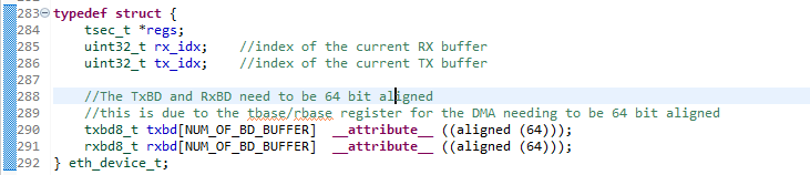

zwilcox
Again, I know this is a dated post.  However, I found this question through searching the forums.
I'm going to post my solution just in case some one in the future has the same problem and is looking for a solution.
TBASE/RBASE must be 64 bit/16 byte aligned.  TBASE/RBASE will truncate the the last 3 bits regardless of what you write.
I resolved this by adding an align 64:
4,381件の閲覧回数

stevensnyder
Hi, Bill.
This is bare-metal code; any memory addresses referenced are physical DDR.  I do not have the MMU turned on.
Regarding the PHY link status: yes, I saw that, but also don't see any evidence that the transmit is even attempted.  Even if the link is down, shouldn't I see at least come activity in the counters, or some error in TSTAT?  As it is there is just nothing.
Also, I am assuming that with loopback set in maccfg1 the P1013 shouldn't care about the state of the PHY.  I could be wrong about that, but the loopback should limit the actions to DMA'ing the packet from the TX BD into the chip, then back out to the RX BD.
