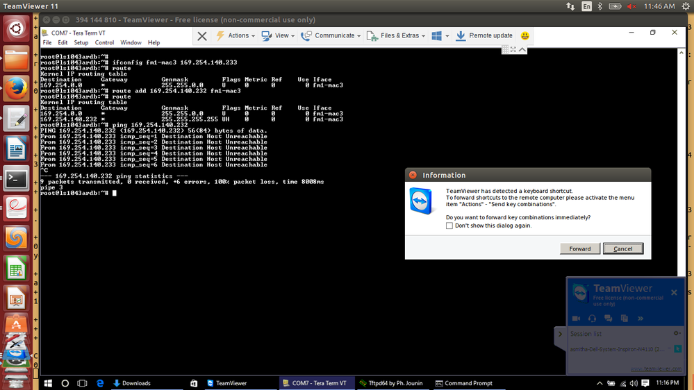

manjunathmandya
Hi Pavel,
     Please find attached screen shot

manjunathmandya
Hi Pavel,
Thanks for reply, we did following steps
1) login as root
2) ifconfig fm1-mac2 169.254.140.233 ( With SDK 0.5 ethx as been renamed as fm1-macx )
3) ping 169.254.140.232 ( my laptop IP address )
it responds as
Network not reachable
Manjunath
