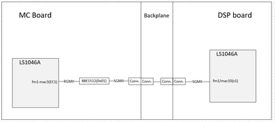

I have three PCB boards setup seen in the picture below. I have two ls1046a processors and they are connected via an sgmii link through a backplane. On the control board a marvell 88e1512 phy is connected to the EC2 RGMII interface of the processor which converts the rgmii->sgmii. On the DSP board this sgmii interface is connected to the lane D of the first serdes block of the processor.

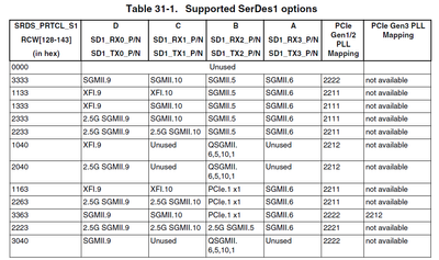

I have setup the RCW serdes protocol bits to 3333 according to the table 31-1 of the ls1046 reference manual.
 My question is that how should I setup the linux device tree entries in order to get this setup work?
Thanks in advance!

SGMII is a MAC-PHY interface by it's definition. If you connect something else, the only available option is a fixed-link. In this mode, no externally connected PHY initialization is done, but the on-chip SerDes still expects that the connected device behaves as an SGMII  PHY in terms of autonegotiation. If the connected device does not respond as a PHY, the link may fail. Changes in the driver code are required to adjust for other autonegotiation options. Details can be found in LS1046ARM, Section 31.8.1

So you mean, that, if I would like to use the PHY in this configuration(explained in my post), then I have to hack the fman driver?

Yes, to support  non-SGMII-PHY link partner you have to alter the driver code. Not exactly FMAN, but mEMAC driver.
