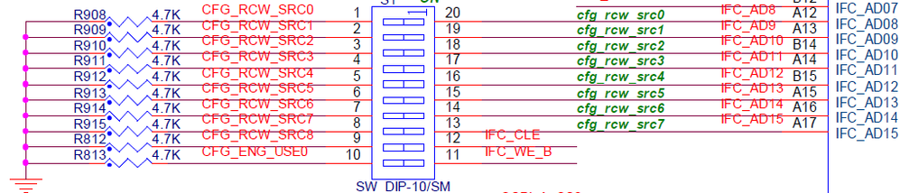

I use ls1046a to design a board, but cannot get the signal of the dial switch(boot source) after powering up.I want to know where something might go wrong?

1.CFG_ENG_USE0 is set 0, use DIFF_SYSCLK  (100MHZ,Peak value of waveform is 640mV)
2. I will check PORESET_B again.
3.All supply voltages are correct, and power sequence is the same with frwy-ls1046a-ac .
2,335 Views
tian_shuliang
1.CPU BOOT Source is as the same with frwy-ls1046a-ac
2.I select sdcard to startup, then set CFG_RCW_SRC[0:8] : 0_0100_0000.When i test DIP-10 PIN 18,there is no signal(RCW can not be read). I test the same pin in frwy-ls1046a-ac,there is a high pulse.
I want to know what will affect Boot Source? eg: Power ? RTC_CLK? SYSCLK ? DIFF_SYSCLK? PORESET_B? or others?

It is required to check:
1) SYSCLK or DIFF_SYSCLK is applied and correctly selected by IFC_WE0_B strapping
2) PORESET_B is applied in accordance with the processor's Data Sheet requirements (Table 23. RESET Initialization timing specifications)
3) All supply voltages are correct
2,335 Views
ufedor
What exactly does it mean?
Please provide detailed technical description of the issue including schematics as searchable PDF.
