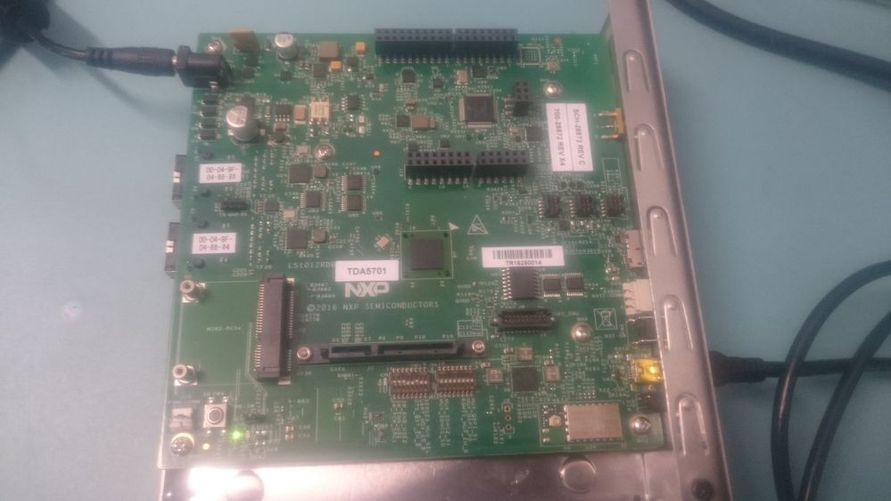

Under Trouble shooting, It says the D20 LED must be on, however it is not on my board.
12,265 Views
ufedor
Please provide a clear photo (top) of the powered board with all cables connected.
12,265 Views
nicholashooper

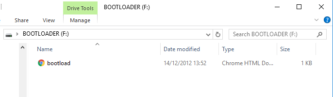

You wrote:
> only appeared as a drive called BOOTLOADER
What are contents of the BOOTLOADER?
12,262 Views
nicholashooper
There is only a HTML File called "bootload"

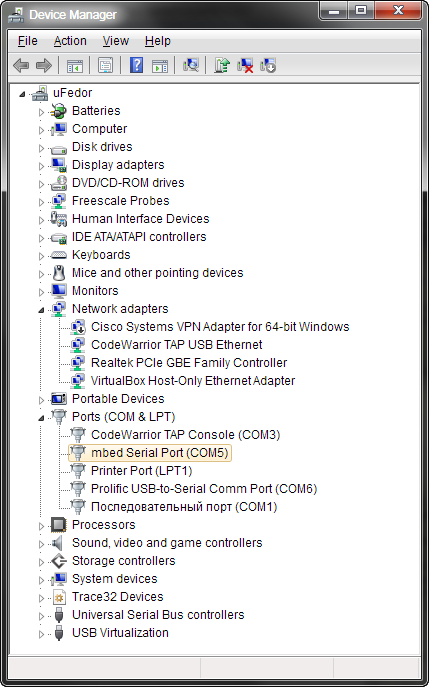

Please copy attached binay image into the BOOTLOADER.
Unplug and plug again the USB cable into the RDB - there should be MBED device instead of the BOOTLOADER:
Also mbed Serial Port should be present in the Device Manager:
