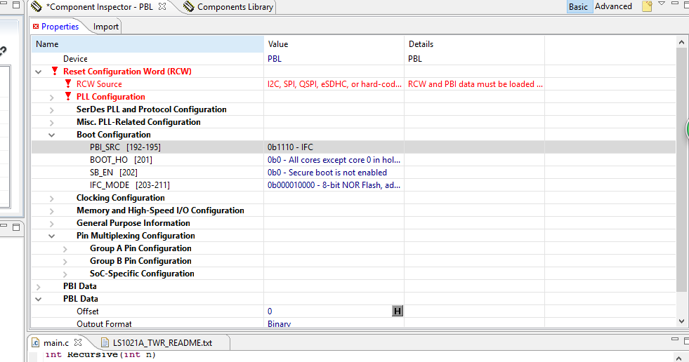

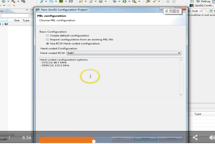

This is my Codewarrior
This is from the instruction user guide of QorIQ
how am I able to bring the hard-coded option to my board since my ls1021a device only has an external eMMC and nothing in it. I need to talk to the CPU via the JTAG interface.

ufedor
Hard-coded RCW option is selected using the reset configuration word (RCW) source inputs, cfg_rcw_src[0:8], which are multiplexed on {IFC_AD[8:15], IFC_CLE}. The configuration inputs has to be strapped by external resistors.

w_arjun

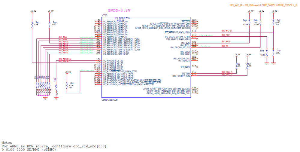

Hi there,
Just trying to get right to the issue here. If we have strapping already in place, for example cfg_rcw_src[0:8] =
0_0100_0000 for booting from SD/MMC (eSDHC) with resistors, how do we program a virgin un-programmed board using JTAG tools?
Is it possible to override the RCW strapping settings as described below?
The scenario here is when the target board arrives from the PCB supplier with the strapping already in place as shown in the attachment.
Other items to note here,
  1. We are using the CodeWarrior TAP (CWH-CTP-BASE-HE) with the Probe Tip CWH-CTP-CTX10-YE for flashing the LS1021A device.
  2. The clock synthesizer is strapped for 100 MHz system and DDR clocks.
  3. It is currently not possible to dynamically reassign the CFG_RCW_SRC pins.
Thank you

ufedor
Yes.

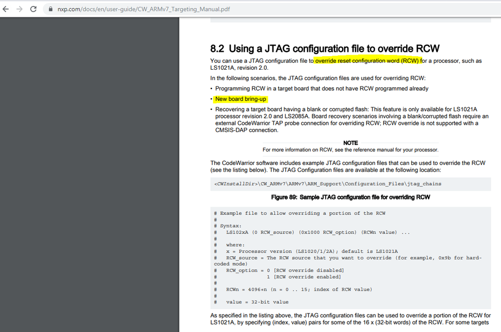

Could you please elaborate on the steps required to get access to the target board using the CodeWarrior TAP (CWH-CTP-BASE-HE)?
5,729 Views
ufedor
Additional essential component to the CodeWarrior TAP is Probe Tip CWH-CTP-CTX10-YE.
Further please read "CodeWarrior for ARMv7 Targeting Manual".

jiye
Contributor V

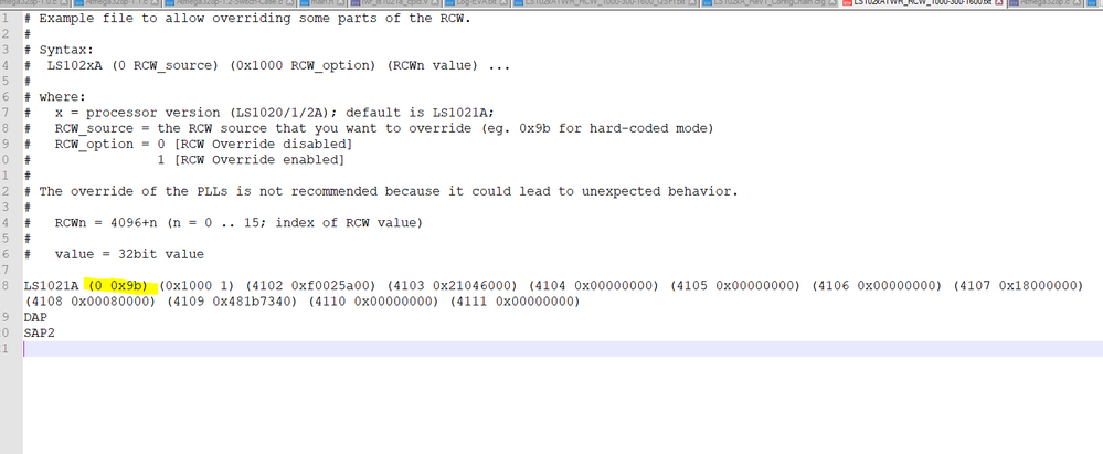

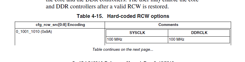

our clock synthesizer is strapped for 100 MHz so we have to use 0x9A right instead of 0x9B?
If so should I change "\CW_ARMv7_v2019.01\CW_ARMv7\ARMv7\ARM_Support\Configuration_Files\jtag_chains\LS102xATWR_RCW_1000-300-1600.txt  to .bin format then load into CW and then change the settings in it and then regenerate it as .bin file and use it as debug RCW hard-coded file ?
5,729 Views
ufedor
Correct.

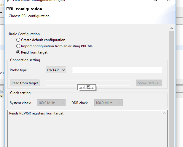

jiye
Contributor V
i dont see anywhere lets me to choose cfg_rcw_src [0:8] in the CW
where can I change the cfg_rcw_src to 0x9a

jiye
Contributor V
I can't import the .bin (converted from LS102xATWR_RCW_1000-300-1600.txt to LS102xATWR_RCW_1000-300-1600.bin)

ufedor
Please read - CodeWarrior for ARMv7 Targeting Manual, 8.4 Setting up a remote system to use a JTAG configuration file. In the step 13 select modified (having 0x9A) JTAG initialization file.

jiye
Contributor V
all of them have 0x9b can I manually modify only
to (0 0x9a) ? without changing other values?
