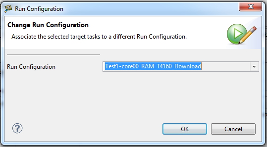

Hi All,
I am using Codewarrior Flashprogrammer  version 10.7 for flash the images to T4160 Machine. After everything done, before execute I seen two type of Debug Context. Execute work after select the Projetc-specified debug context (Texst1_core00_RAM_T4160_Download).
I don know what is the difference and which one I want to use for flashing?
Chosse Target Task file -> Change Run Configuration -> Select Run Configuration and Click -> ok in Target Task Pop Window.
If it possible, Please send to appropriate steps for flash by using Codewarrior Flashprogrammer version 10.7. Thank you for all!

ufedor
Active Debug Context (= active debug session) is:
<> debug connection was established and is active
and
<> processor initialization script was executed
During a project creation it is possible to check Debug Configurations "Connect", "Download", "Connect SRAM" and "Download SRAM" - each of them can establish debug session required for the Flash Programmer.
Latter two can be used if SDRAM operation is unstable.
