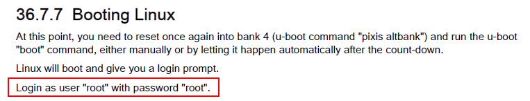

Default pass for root user is root.

I have tried "root" and it does not work.

Did you read the prior reply?  I have tried user root, password root.  IT DOES NOT WORK.  Please see the initial question for  a precise description of the build in the unit.

I still have not received a reply on this.  I am wondering if there could be a problem with the serial line configuration.  I would not think so, since it does display "root" when I type "root".
The dialog is below:
Poky (Yocto Project Reference Distro) 1.6.1 ls1043ardb /dev/ttyS0
ls1043ardb login: root
Password:
Login incorrect
ls1043ardb login:
