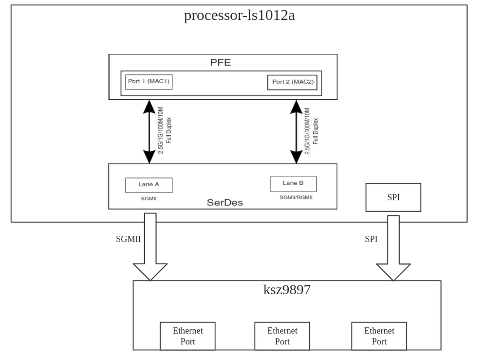

I am using the Linux 5.3 from nxp on my board (with ls1012a).  See the Figure 1 below.
Figure 1: Connection between ethernet switch and ls1012a

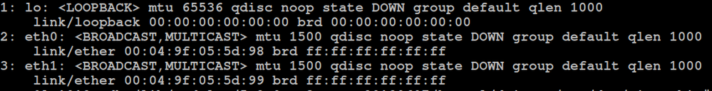

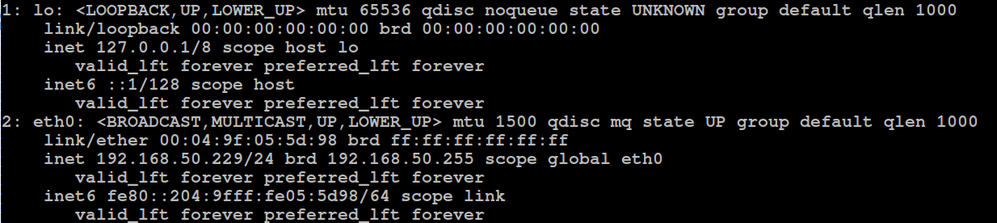

When the board is turned on, I can see three interfaces lo, eth0 and eth1. See figure 3.
Figure 3: lo, eth0,and eth1
I configured eth0 with a static ip and a proper netmask, also I set up the route table, see Figure 4.
Figure 4: eth0 with static ip

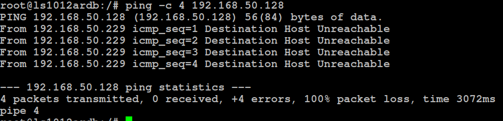

But when I tried to ping an other device connected to my board directly(in the same network). It failed with +4 errors. See Figure 5.
Figure 5: Ping with errors

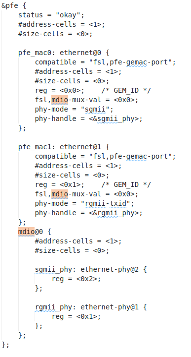

I assume the problem is a result of incorrect device tree. I modified fsl-ls1012a-rdb.dts(reference board device tree)  to be my device tree source.  Figure 6 is the pfe node. In my board, I am using dspi to control the ethernet switch(ksz9897), but in ls1012ardb, it uses mdio instead. I am not sure if I should delete the mdio node here or how to connect ethernet switch in device tree.  In the pfe node below, there is mdio sub node.

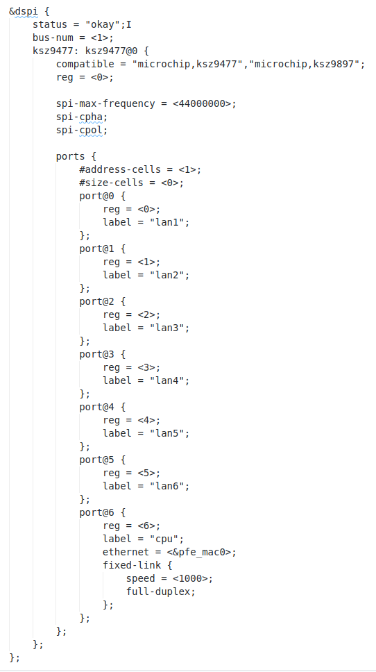

In dspi node, I added a sub node for the ethernet switch. see Figure 7 below.  So I am not sure where is the problem, is it between PFE and switch or between DSPI and switch.

Also there is no dmesg output for the etherenet swith node (ksz9477, which is connected to dspi).
It seems that the PFE MAC 0 is not talking to the ethernet switch at all.  All packets stopped at MAC. I assume that, in the device tree, the PFE MAC 0 is not connected to the ethernet switch logically yet or the switch on the dspi is not detected. Port 7 of this switch is connected to PFE MAC 0, see figure below, LAN1, LAN2 and LAN3 are used to plug in the etherenet cable.
                                                                 Figure 2: Ethernet switch connection

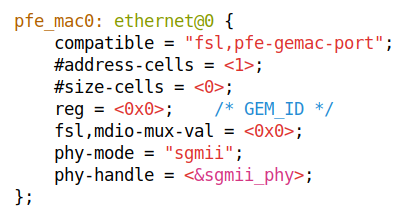

In the previous pfe_mac0 node(for ls1012a-rdb), I noticed there is a variable called phy-handle,  I am not sure if it is used to connect the switch to the PFE MAC. see figure below:
                                        Figure 3: pfe_mac0 node for ls1012a-rdb reference board.

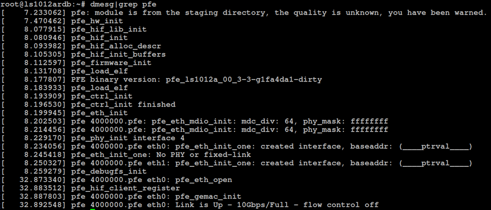

Also the dmesg about pfe is shown below:
                                                                Figure 4: dmesg PFE output
Any help will be much appreciated,

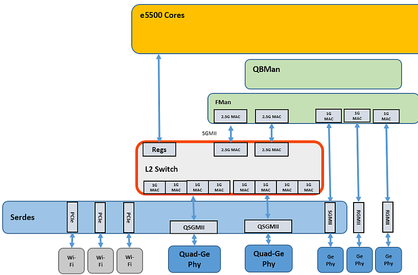

Please refer to L2switch design in T1040RDB.
8 Gigabit switch ports are external ports and are connected to external Phys
2 switch ports (2.5G) are connected to FMan ports
Internal ports connect to DPAA are defined as the following.
                        enet0: ethernet@e0000 {
                                fixed-link = <0 1 1000 0 0>;
                                phy-connection-type = "sgmii";
                                rcpm-wakeup = <&rcpm 0x80000000>;
                        enet1: ethernet@e2000 {
                                fixed-link = <1 1 1000 0 0>;
                                rcpm-wakeup = <&rcpm 0x40000000>;
Yiping
