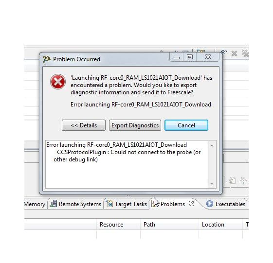

pranavmadhu
Hi Adrian,
Is it J25 or J26 on IOT Board? You mean to connect the board with PC using a micro USB cable? While trying to debug we got some error. I've attached the error message. We have done on 32 bit windows 7 PC.Screenshot005.jpg
Thanking You,
Pranav
5,582 Views
addiyi
Yes, connect the board with the PC using mini usb port. Also, check the device manager from your machine, to verify that the CMSIS-DAP device is installed correctly.
Adrian
5,582 Views
pranavmadhu
In device manager it is showing as USB Mass storage Device. So what to do next, can you pleas guide me for the same
