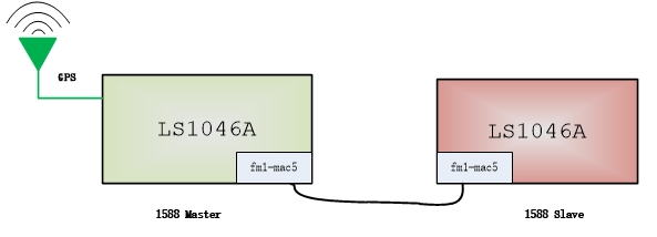

HI:
    Network topology:
          The master and slave can be synchronized using ptp4l.
          The Master's TESC_1588_PULSE_OUT1 and the Slave's TESC_1588_PULSE_OUT1 are aligned.

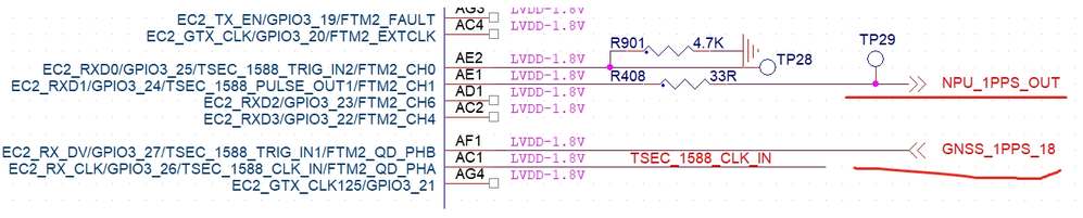

      My question is as follows:
          how to configure TESC_1588_PULSE_OUT1 and TESC_1588_TRIG_IN1(GPS's 1PPS input) are align in Master?
        Thanks a lot!

yipingwang
Please refer section 17.5 Synchronizing Linuxptp time with GPS on DU side board in LA1224-RDB-BSPUG.
Let me know if you have further queries.
