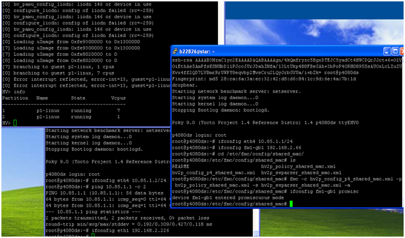

2 . How to Set up Hypervisor
In Linux SDK, the default configuration is for setting up hypervisor from NOR Flash, this document will introduce how to modify hypervisor device tree and boot hypervisor system from RAM.
2.1 Modify hypervisor device tree
In SDK 1.6 hv.dts, there is a node defining one physical memory area for booting from RAM, so all the images should be deployed inside this area.
images_pma: images_pma {
compatible = "phys-mem-area";
addr = <0x0 0x78000000>;
// Used for boot-from-RAM
size = <0x0 0x04000000>;
// 64MB
Modify the guest images addresses as the following.
  part1 {
// Indicates that it is a partition node
compatible = "partition";
label = "p1-linux";
// CPUs #0 to #6 are assigned to this partition
cpus = <0 6>;
guest-image = <0x0 0x78020000 0 0 0 0x700000>;
linux-rootfs = <0x0 0x79300000 0 0x01300000 0 0x02800000>;
dtb-window = <0 0x1000000 0 0x20000>;
part2 {
label = "p2-linux";
// CPU #7 is assigned to this partition
cpus = <7 1>;
2.2 Deploy hypervisor images
Under u-boot prompt, deploy the following images.
=>tftp 78020000  uImage-p4080ds.bin
=>tftp 79300000  fsl-image-core-p4080ds.ext2.gz.u-boot
=>tftp 78700000  hv.uImage
=>tftp 0x78800000  uImage-p4080ds-usdpaa.dtb
=>tftp 0x78900000 hv.dtb
Here specify the physical address of hv.dtb from u-boot environment.
=>setenv bootargs config-addr=0x78900000 console= ttyS0,115200
=>bootm 0x78700000 - 0x78800000
2.3 Use mux_server to connect to partitions
Use the mux_servre to the target board to ensure that individual UART streams are decoded correctly on the host side.
mux_server -exec "bft connect P4080DS-1" 18900 18901 18902&
Note: “bft connect P4080DS-1” is the command to connect to the UART console.
If the device is attached at /dev/ttyS0 and export mux channels, the command should be as the following.
mux_server  /dev/ttyS0 18900 18901 18902&
socat -,raw,echo=0 tcp:0:18900
socat -,raw,echo=0 tcp:0:18901
socat -,raw,echo=0 tcp:0:18902
