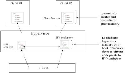

1.3 Hypervisor device trees
The hypervisor configuration tree contains all hypervisor configuration parameters and partition definition information. Based on this configuration tree, the hypervisor dynamically creates ePAPR-compliant guest device trees for each partition. A guest device tree describes the resources available to the partition including—CPUs, memory, I/O devices, and other virtual resources.
Figure 1-2 Hypervisor configuration trees
