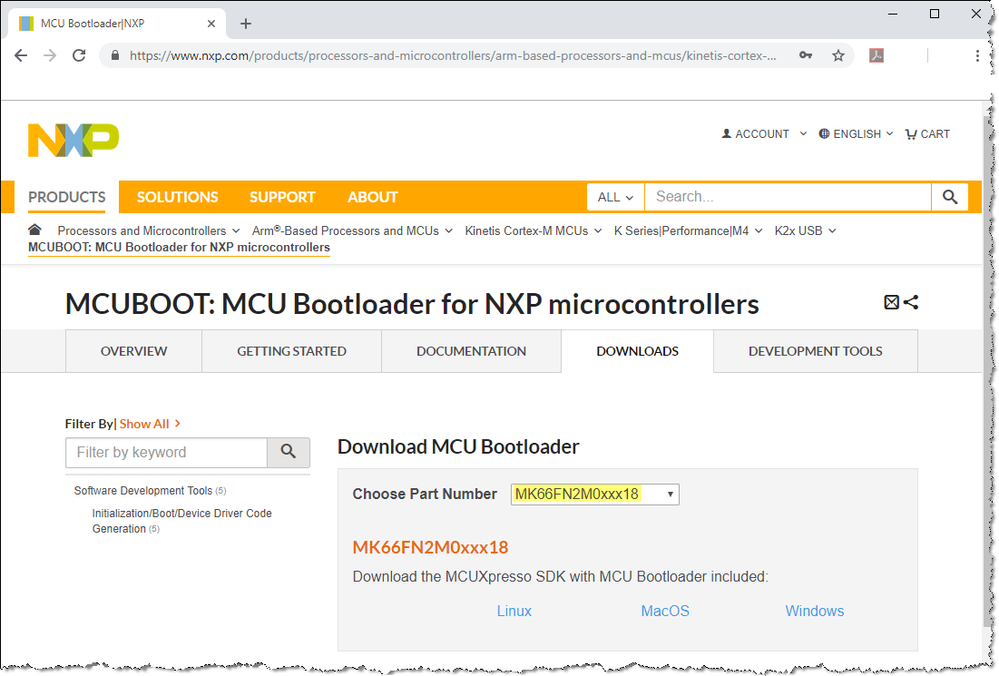

Our company is evaluating upgrading from MK60FN1M0VLQ12 to MK66FN2M0VLQ18 and I was reading this document
https://www.nxp.com/docs/en/data-sheet/K66P144M180SF5V2.pdf
The document states " These devices maintain hardware and software compatibility with the existing Kinetis family." does that mean that the bootloader for MK60FN1M0VLQ12 would work for MK66FN2M0VLQ18 ?
Could someone please help me out here, I do not know who else to ask!
Cheers

Hi TJ,
No. You may need to compare the difference of memory map between two MCU.
In fact you can direct download the latest MCUBOOT for MK66FN2M0xxx18.
The documents can be found in it's folder.(...\MK66FN2M0xxx18\middleware\mcu-boot\doc)
Robin
