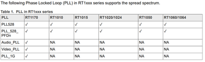

Yes, I looked at AN12879 and was able to find the formula below in that document.
- Spectrum spread range = Fref * ss_stop/DENOM
- Modulation frequency = Fref * ss_step/(2*ss_stop)
I created the above function based on that formula, but the signal strength does not change.
Additionally, I analyzed the code and found that the semc clock is coming from kCLOCK_PllArm(600Mhz) div 3. In this case, does spread spectrum not work?

Please try to use System PLL (PLL2) for Spread Spectrum.
Please also take a look to section 14.6.1.3.2 in the RT1060 RM.
Daniel.
3,780 Views
seobi
Thank you for your help. We changed it to PLL2 and confirmed that it operates normally.
